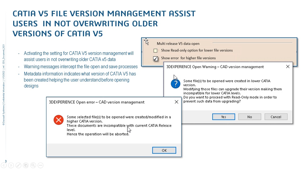

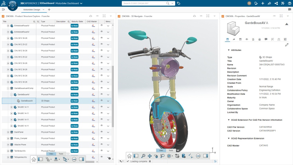

Enhance collaboration between users with different release levels of their CATIA V5, by storing more extensive release level information.
Product definition is extended with information about the CATIA V5 release used when creating and most recently saving the file Options are made available to control the behavior when collaborating using different release levels of CATIA V5. Accidental overwrite of content from an older release of CATIA V5 can therefore be avoided Enhance user collaboration using different CATIA V5 release levels by providing additional release information and options to receive warnings in CATIA V5 informing about a potential overwrite

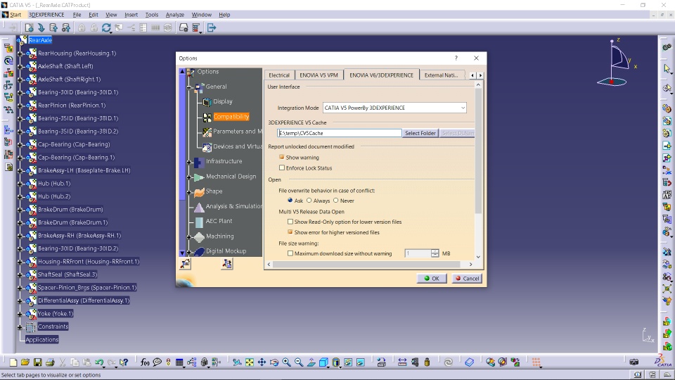

All three enhancements are great, but I am not able to get it on R31-PowerBy (latest SP & HF) and with R32-PowerBy(latest SP & HF). Some infos how to achieve it would be great. Maybe here in this Wiki Page?
AA
AA2022-04-14
I just installed the latest HF in CATIA R32 SP1 with the latest UE5 and I do not have all options shown:
