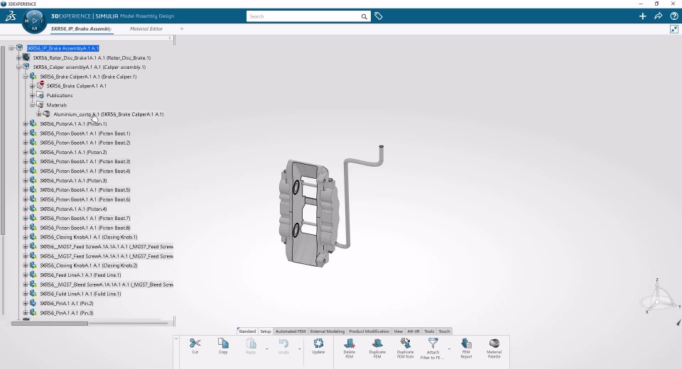

Accurate Weight computation and Structural Simulation of CATIA V5 data on the 3DEXPERIENCE leveraging existing CATIA V5 Materials
