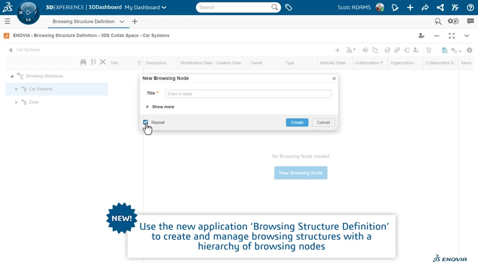

Users can define the browsing structure consisting in a hierarchy of Browsing nodes and manage their maturity.
User Experience Value
With the new application “Browsing Structure Definition”, one can define new ways to organize and navigate Engineering Definitions. Up to 20 Browsing Structures can be created to offer enterprise's organizations or disciplines a way to present and navigate the Engineering definitions in the most convenient way for their needs. This capability fits with Engineering Definitions leveraging the “First Level configuration” methodology.
In the Classification Manager role, the Browsing Structure Definition application was introduced to define alternative Browsing Structure for Engineering Definitions. In Product Explorer, Product Structure Editor, Engineering Release and Product Structure Design, instances of an Engineering Definitions can be organized and displayed according Browsing Structure hierarchy to ease the navigation of Engineering Definition that include a large amount of instances.
