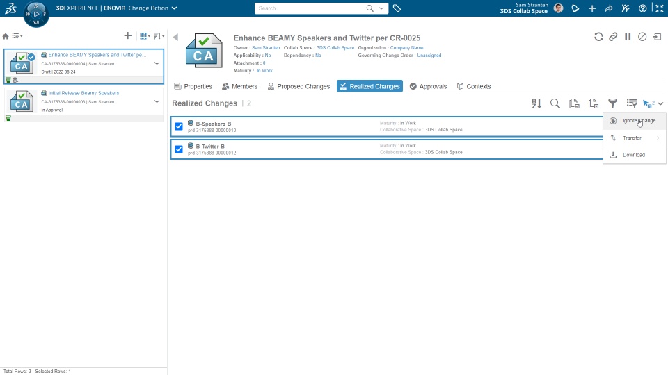

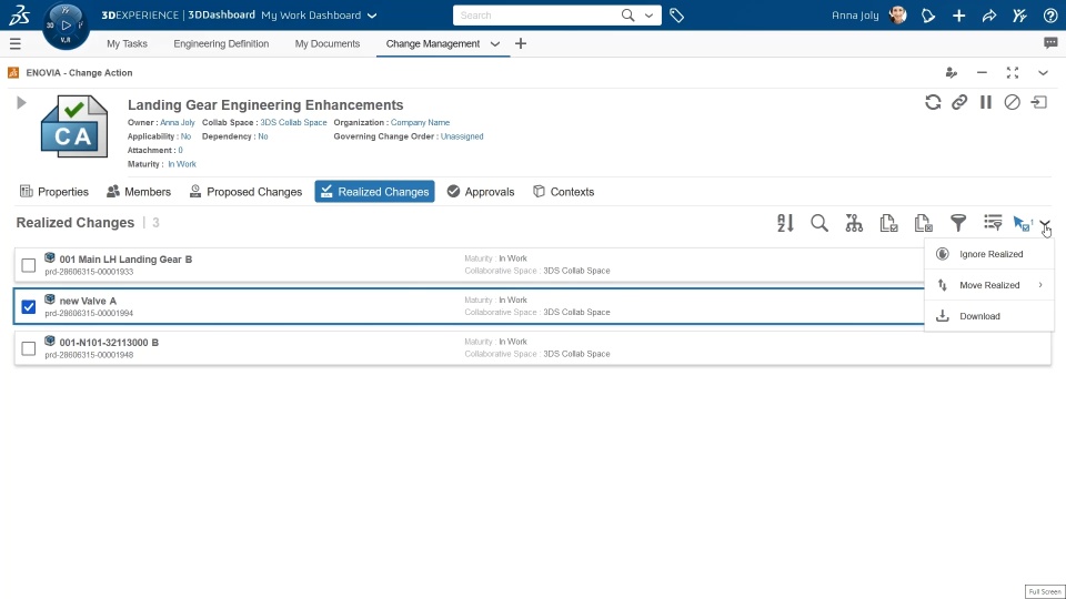

Provide change action assignees the ability to mark non-relevant Realized Items as ‘Ignore’ to improve the effectiveness of approval and validations.
Change action owners and assignees have the need to rationalize the items captured on the Realized during their work-under sessions. In some cases, items captured may not be relevant to the users approving the change. In this release, Change Action users will be allowed to mark Realize items as "Ignore". Ignored Realized Items will disappear from the "Track Items" filter. A new filter option will be provided to users reviewing the change to view all "Ignored Items"
Change action users can now filter realized items to view all Tracked Items vs Ignored Items
Change action assignees or owners can ignore realized items that are not considered for the change action or have been added by mistake during work-under.

Great enhancement. However, if you accidentally make the wrong item as "Ignore" how do you "Un-Ignore" it.
