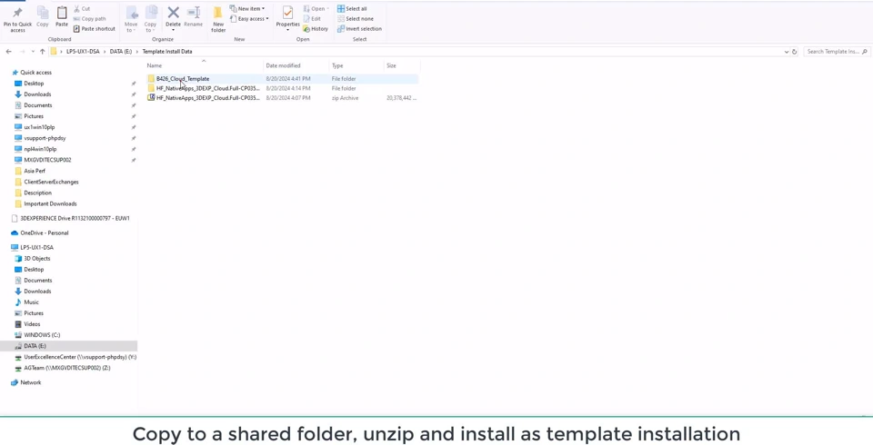

Here is the link where you can download the document which explains how to install Desktop Apps in Silent/Batch mode.
https://www.3ds.com/support/documentation/resource-library/3dexperience-cloud-native-apps-batch-installation
Based on the above document below are sample videos on how we can install Desktop Apps in Silent/Batch mode from scratch (Full Install) and also to update the existing installation to the latest HF.
Full Install From Scratch:
Update Existing Installation to the latest HF:

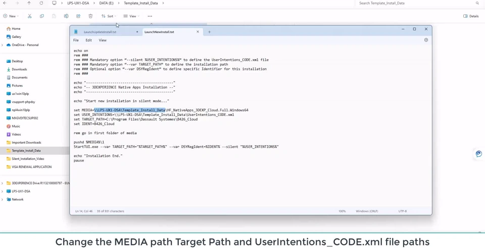

Also find below sample .bat files which can be used for the silent/batch installations:
echo on
rem ###
rem ### Mandatory option “--silent %USER_INTENTIONS%” to define the UserIntentions_CODE.xml file
rem ### Mandatory option “--var TARGET_PATH” to define the installation path
rem ### Optional option “--var DSYRegIdent” to define specific Identifier for this installation
rem ###
echo "-------------------------------------------"
echo "-- 3DEXPERIENCE Native Apps Installation --"
echo "Start new installation in silent mode..."
set MEDIA=\\HF_NativeApps_3DEXP_Cloud.Full.Windows64
set USER_INTENTIONS=\\Template_Install_Data\\UserIntentions_CODE.xml
set TARGET_PATH=\\Program Files\\Dassault Systemes\\B426_Cloud
set IDENT=B426_Cloud
rem go in first folder of media
pushd %MEDIA%\\1
StartTUI.exe --var TARGET_PATH="%TARGET_PATH%" --var DSYRegIdent=%IDENT% --silent "%USER_INTENTIONS%"
echo "Installation End."
pause
