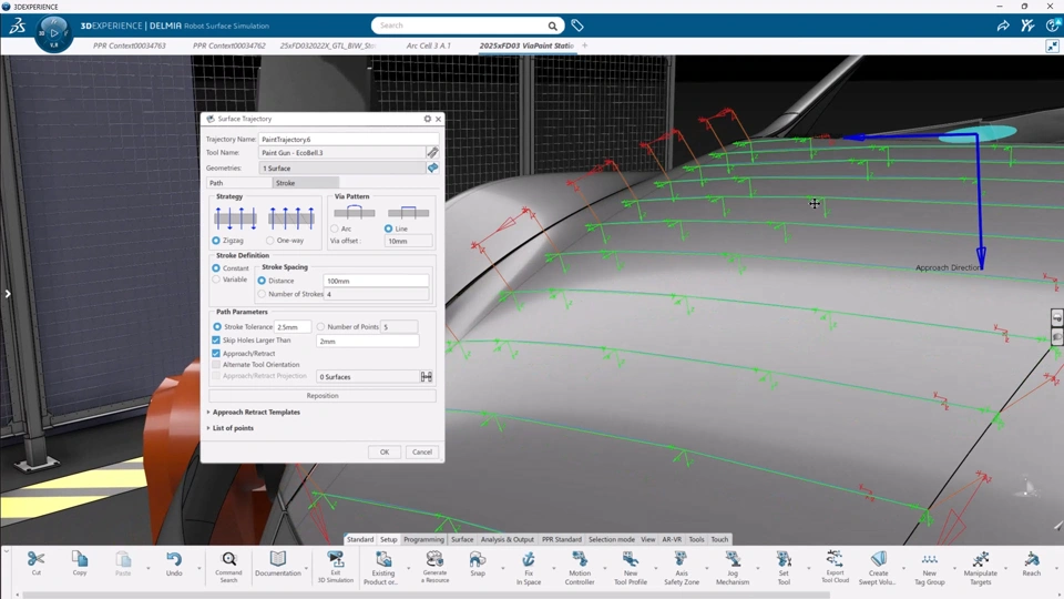

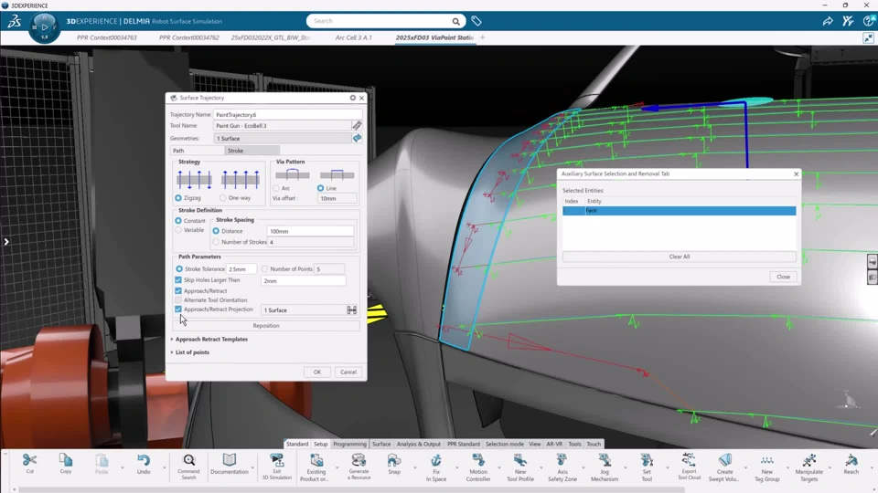

[DELMIA] Surface Robot Programmer
Create more precise robot surfacing operations by using adjacent surfaces to optimize the approach and depart points of the robot trajectory.
The robot approach and depart locations assume the surface normal of the surfaces selected by the user.
The optimized robot path provides the user a better robot surfacing strategy
