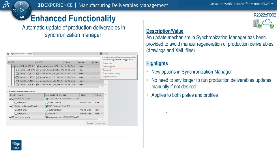

- automatic update mechanism for workshop drawings in Synchronization Manager to avoid having to run  a manual update of drawings after modifications

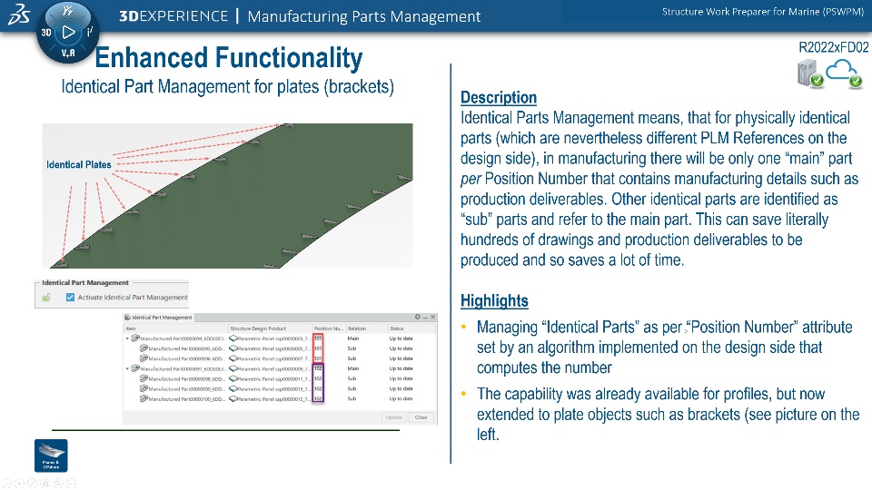

- Identical Part Management Support for brackets to drastically lower the number of production outputs (drawings & XML files) from n (n can become a big number) to just a few

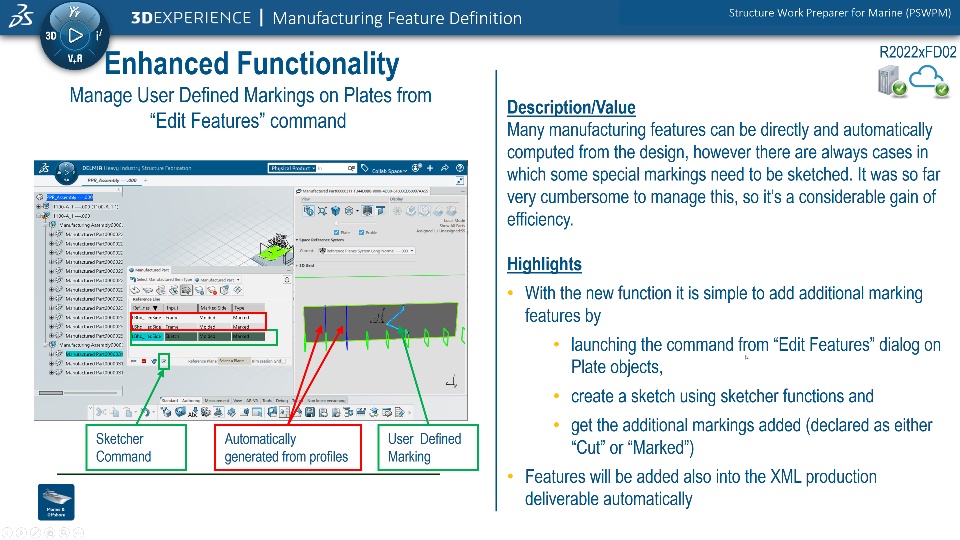

- Efficiently add special manufacturing features by managing user-defined markings on plates with the new 'edit features' command within the DELMIA app without having to switch to CATIA.

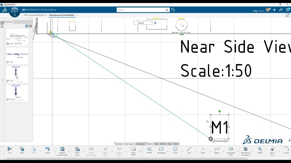

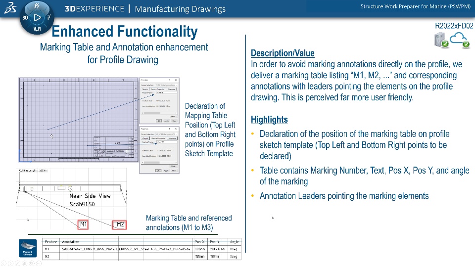

- Produce profile drawings with less manual effort with improved layout flexibility features in Marking Table & Annotation Management

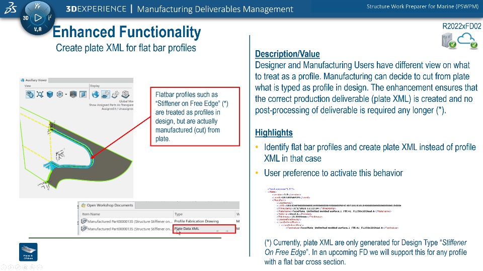

- Plate xml format support for flat bar stiffeners to support the case that design modeling (as stiffener) is different from manufacturing process (cut from plate)
Marking table and annotation enhancement for Profile Drawings
Marking table and annotation enhancement for Profile Drawings (Details)
Create plate XML for flat bar profiles
Identical Part Management for plates (brackets)
Manage User Defined Markings on Plates from “Edit Features” command
Automatic update of production deliverables in synchronization manager
