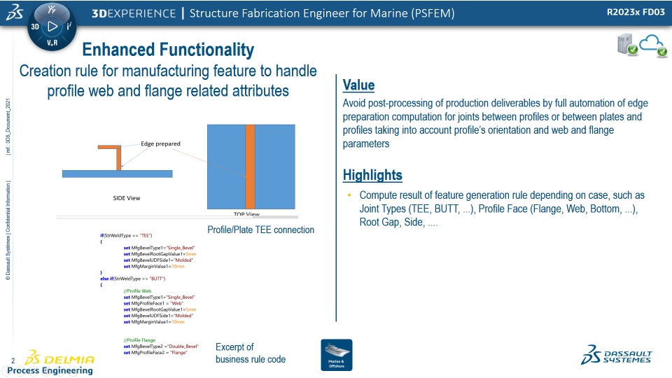

---by automating the edge preparation computation for joints between profiles, or between plates and profiles, taking into account profile’s orientation and web and flange parameters

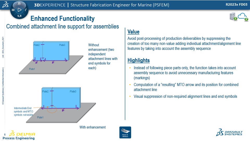

---by suppressing the creation of non-value added individual attachment/alignment line features, by taking into account the assembly sequence

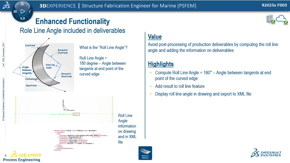

---by computing the roll line angle and adding the information on deliverables

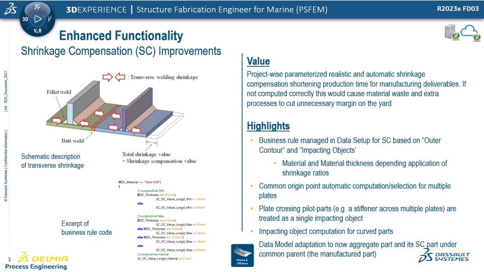

- Shorten production time for manufacturing deliverables with project-depending, realistically parameterized and automatic shrinkage compensation. This prevents the cutting of unnecessary margins, eliminating material waste and excess process time.

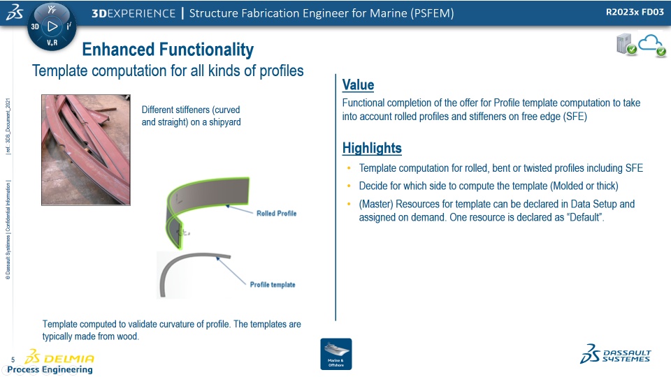

- Profile template computation now takes into account rolled profiles and stiffeners on free edge (SFE)

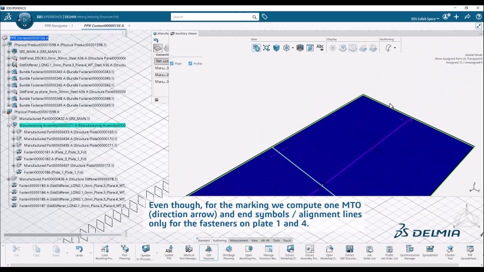

Combined attachment line support for assemblies (video)
Combined attachment line support for assemblies (illustration)
Creation rule for manufacturing feature to handle profile web and flange related attributes
Shrinkage Compensation (SC) Improvements
Roll Line Angle included in deliverables
Template computation for all kinds of profiles
