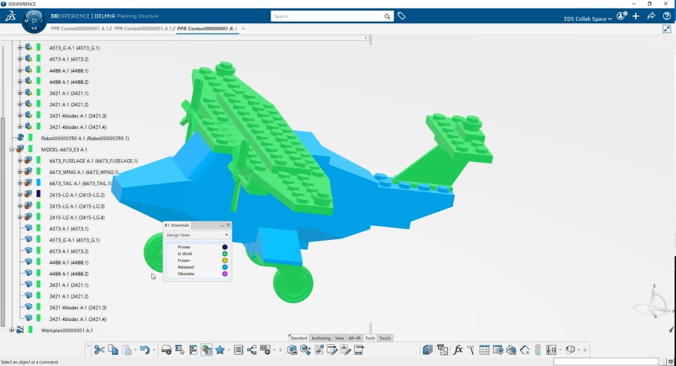

• New BI easily identifies, through color-coded maturity states, both consumed and defined objects

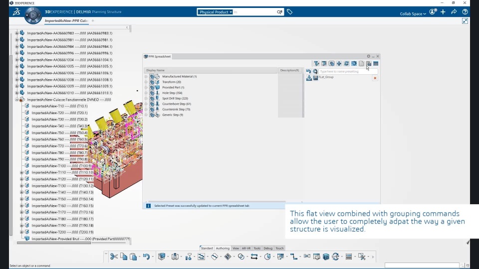

• A new structure visualization mode within the PPR spreadsheet editor – Flat View, allows the user re-organize the original structure and dynamically creates it based on any grouping criteria (reference, attribute value or object type)

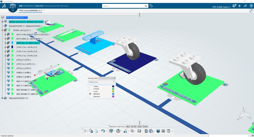

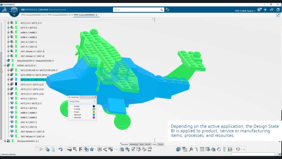

New BI Design State for all Manufacturing Items
By activating the BI, all relevant Manufacturing & Service Objects for the current Application are colored according their Maturity state (Private, In Work, Frozen, Released or Obsolete here)
In Planning Structure or Service Process Structure application, Product, Manufacturing Items, Workplans/General Systems, Operations and Resources are colored in both tree and 3D

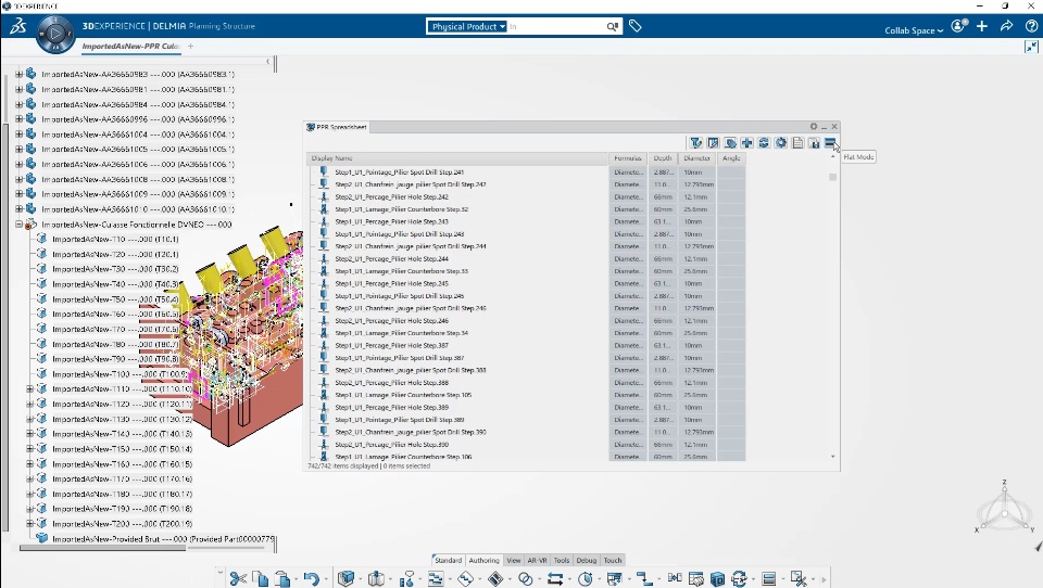

New 'Flat View" command in the PPR Spreadsheet editor
You can toggle from standard multi-level view to flat view, with all instances at the same level, and reverse

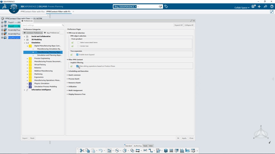

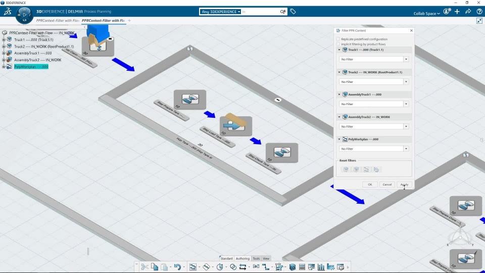

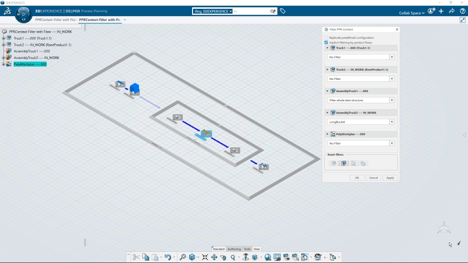

New filtering capability to implicitly filter your Process data (Operations) based on filtered Manufacturing or Service Items structure
A new option allows filtering all siblings Operations without any consumed Manufacturing or Service Item, within a sequence of filtered-out Operations.
In the Filter PPR Content when ‘Implicit filter’ option is checked, as soon as a filter is applied to the Manufacturing or Service Items structure, the Process structure will be filtered as well implicitly.
