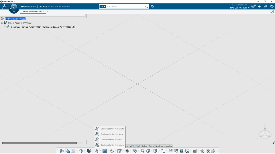

- manage of non-discrete part quantities with specific Service Items

Dedicated Continuous Service Items to manage non discrete quantities within the Service BOM

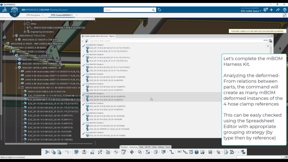

Manage Deformable Parts specification input from Engineering BOM to be consumed in the Service BOM Leverage “deform from” relationship from Engineering BOM to retrieve and consume directly original non deformed item Usage of the same Service item reference whatever the deformed representation Defined your Process & Work Instructions on top of a consistent Service BOM (one single reference for all deformed representations)
