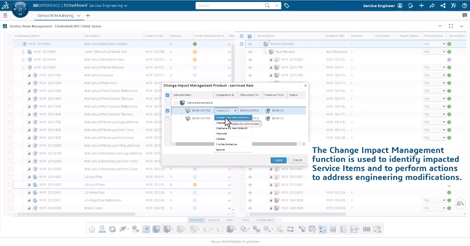

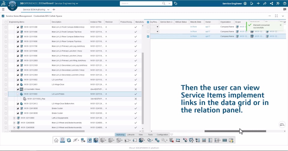

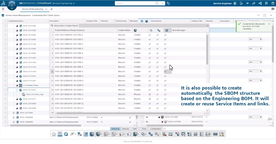

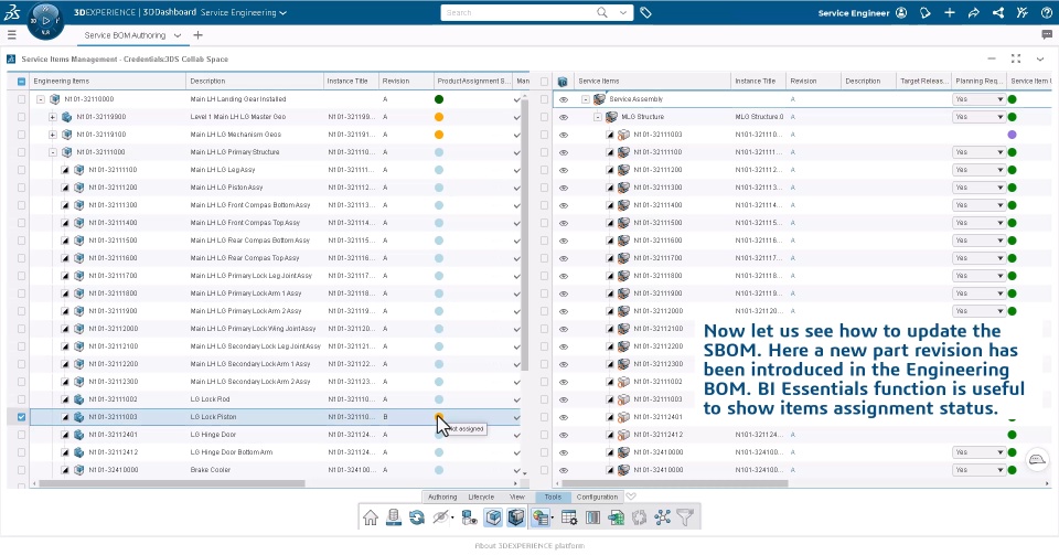

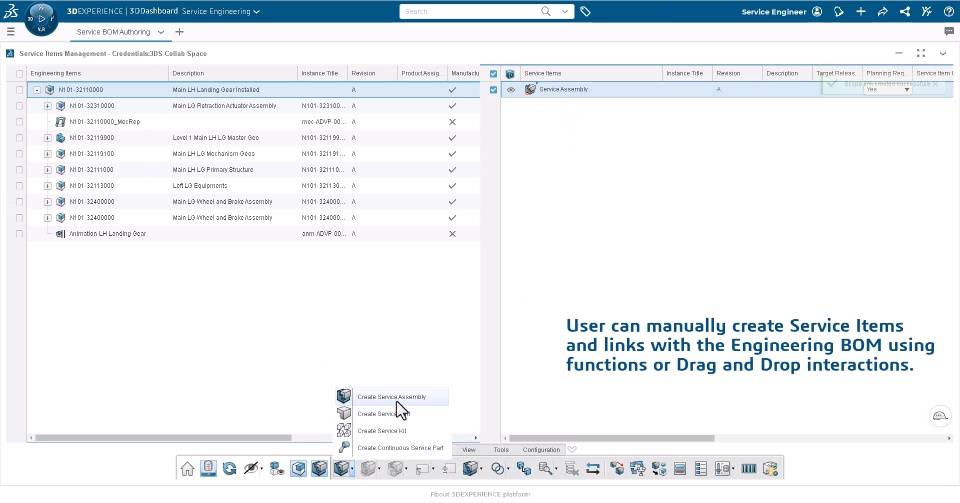

Enables the Service Bill of Material or SBOM with Spare part policy (also known as the Service Items Structure) to be defined, managed, and updated directly from the 3D design data. It is a web-based solution that uses the 3D Product Structure as input for authoring the Service Items Structure, allowing it to be leveraged across Maintenance downstream.
Enable Service Bill of Material with Spare part policy management in new Service Items Management App. Manual creation of Service Items and Links with the Engineering Bill Of Materials. Automated creation of the Service Bill Of Materials based on the Engineering Bill Of Materials. BI Essentials function used to identify visually Engineering and Service Items assignments status. Change Impact Management function allows automated identification of Engineering Items modifications and performs corrective action on Service Items.
