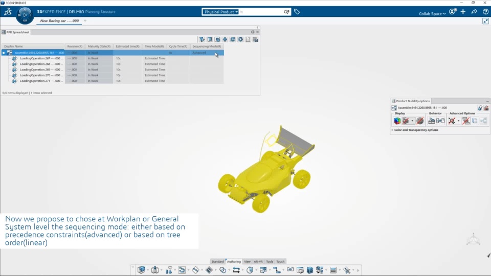

Simplify the user experience for linear processes definition

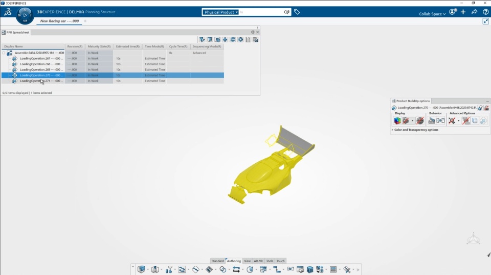

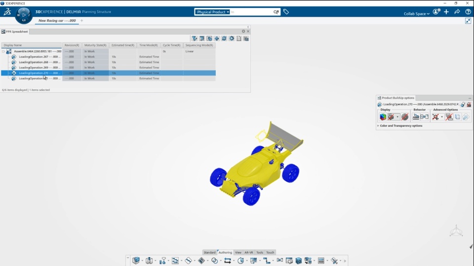

  • System directly relies on the spec tree order, making it unnecessary to manage constraints between operations
  • Directly change the spec tree to reorder the process sequence
Simplified user experience for linear processes definition relies on tree order, not on previous constraints
Manage the sequencing mode - either linear or advanced at the workplan or general system
Here the linear mode relies on the tree order to display the product build up
The classic sequencing mode (called advanced), which relies on previous constraints (product flows and time constraints) is the default.
