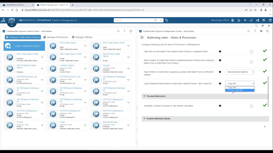

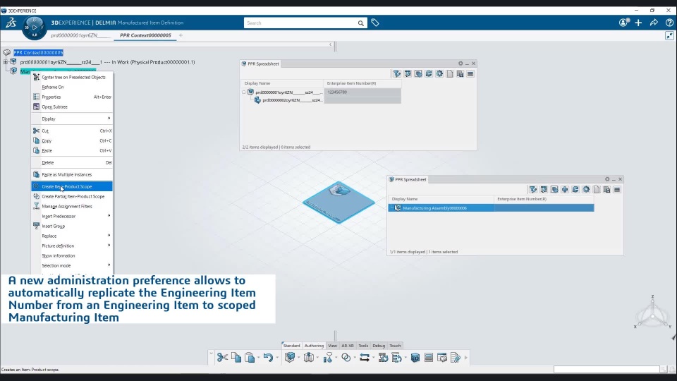

Improve end user experience by automating non-value added actions:
- automatically replicate Engineering Item Number (aka Part Number) on scoped Manufacturing Item
New capability to automatically replicate Engineering Item Number (aka Part Number) from Engineering Item to scoped Manufacturing Item
Dedicated administration option to allow or not the automatic copy of Enterprise Item Number

Hello @AB will this functionality work only for Native Apps in 23xFD03 level? Thanks.
GR
GR 2023-07-06
Is this setting present in the Cloud or only for On Prim?​
LP
LP 2023-07-08
​You probably mean Enterprise Item Number, not Engineering Item Number? Or has there been a change on terminology?
