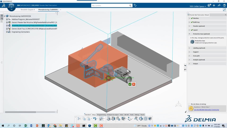

1.In 3D printing of fragile polymer parts it can be necessary to create a protective box to group these small parts and to protect them. The protective box allows also to quickly identify a group of parts for post process application.

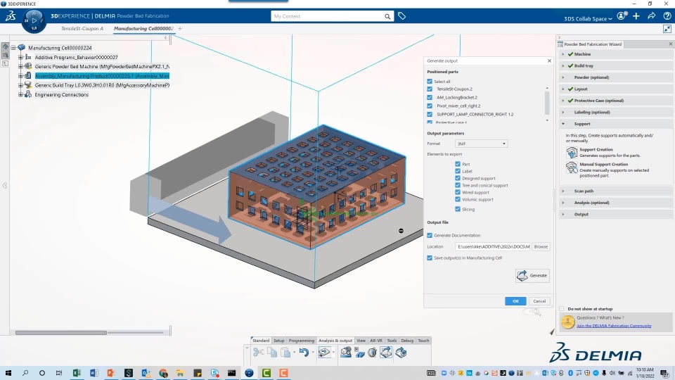

2. Create Shop Floor documentation of the 3DPrinting process with main parameters for traceability & archives.
Protective case
Shop Floor Documentation
