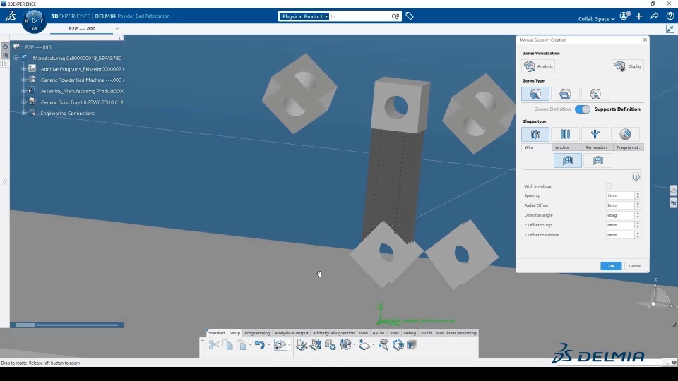

1. Optimize supports placement by enabling supports between 2 parts. In case on complex nesting, allow to minimize supports number.

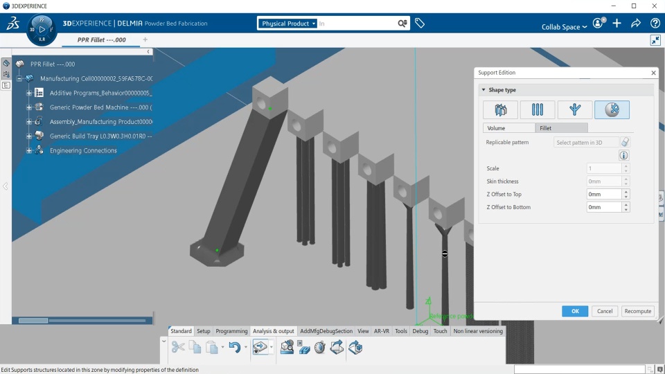

2. Add fillets between support attachments & Build plate to avoid cracks during cool down.
