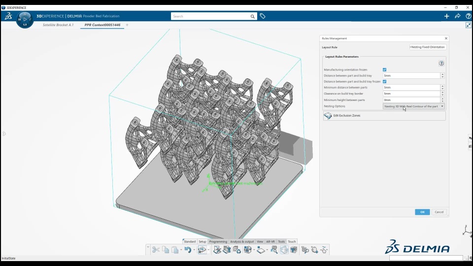

In 3DPrinting, 3D Nesting is a critical step in the build preparation stage. This new enhancement will enable users to automatically nest parts in 3D to maximize the print chamber volume. If the number of parts exceed the volume, a warning message is displayed to the user to reconfigure the input quantity for nesting.

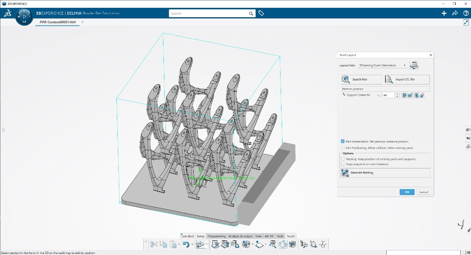

3D Nesting with fixed part orientation to respect the optimized orientation previously computed.

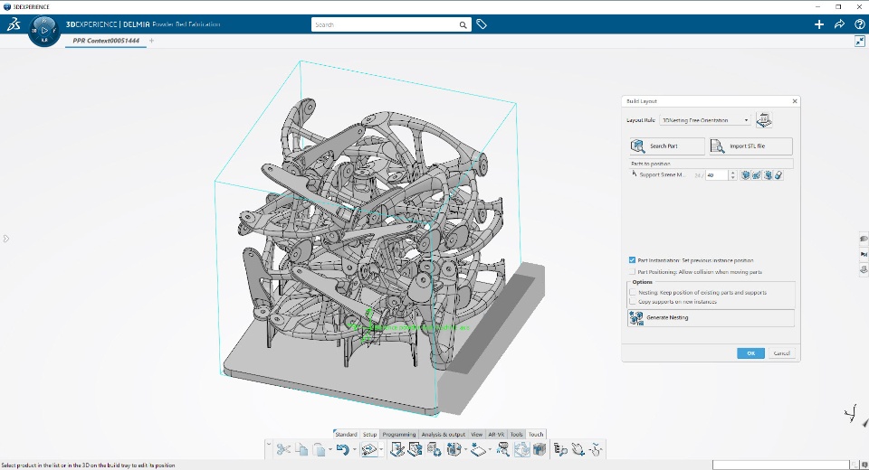

3D Nesting with free part orientation to maximize the number of parts in the build envelope.
