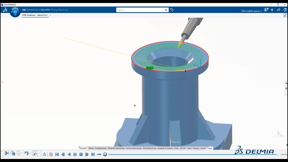

1. Cycle segment end mills are now able to remove more materials than the standard end mill tools.A higher axial depth compared to classic end mill tools reduces machining time, while the large radius of the tool enhances the surface quality. This enhancement presents both reduced machining times and higher quality results.

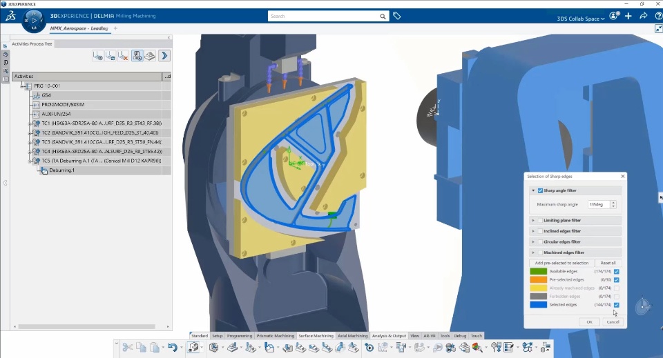

2. A new deburring function takes the manual task out of the finishing process by automatically flattening the sharp edges on a part.

Reduce machining time by supporting tapper barrel cutters
New activity for Deburring with automatic computation of edges

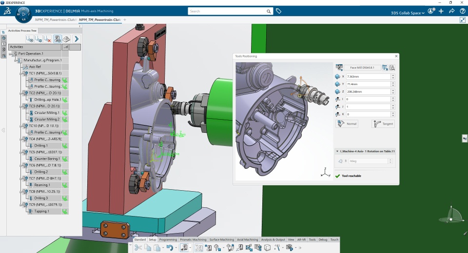

New UI to check the reachability of the NC Machine
