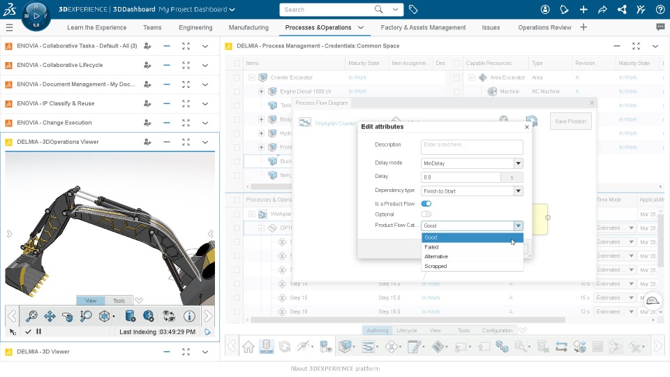

Extend the process definition for execution by managing conditional product flows between operations, supporting alternative paths in the process sequence and defining a category for each product flow:
• Good (default)
• Alternative
• Scrapped
• Failed

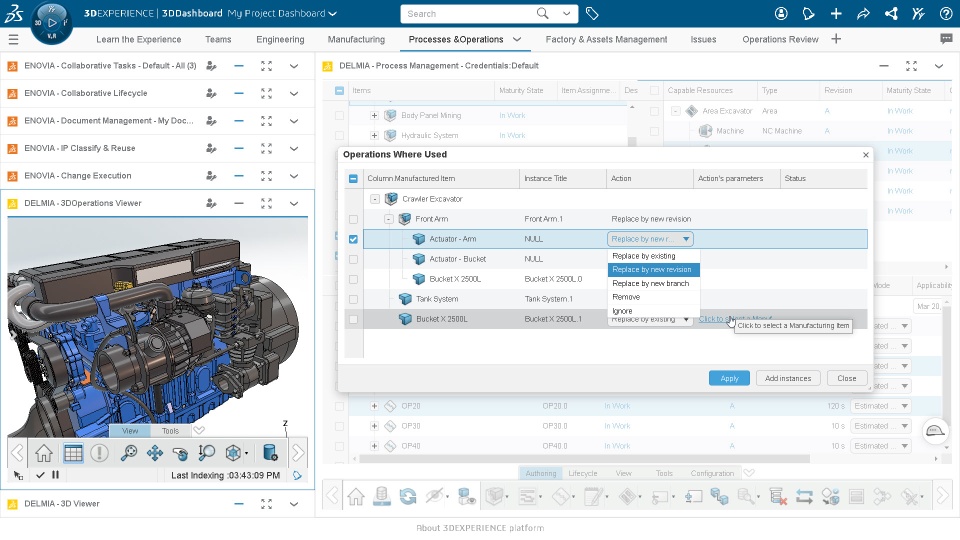

Easily manage multiple updates (replace by, remove, add) by applying the same modifications for multiple instances of Manufacturing Items, on a given reference, using a single user interface.

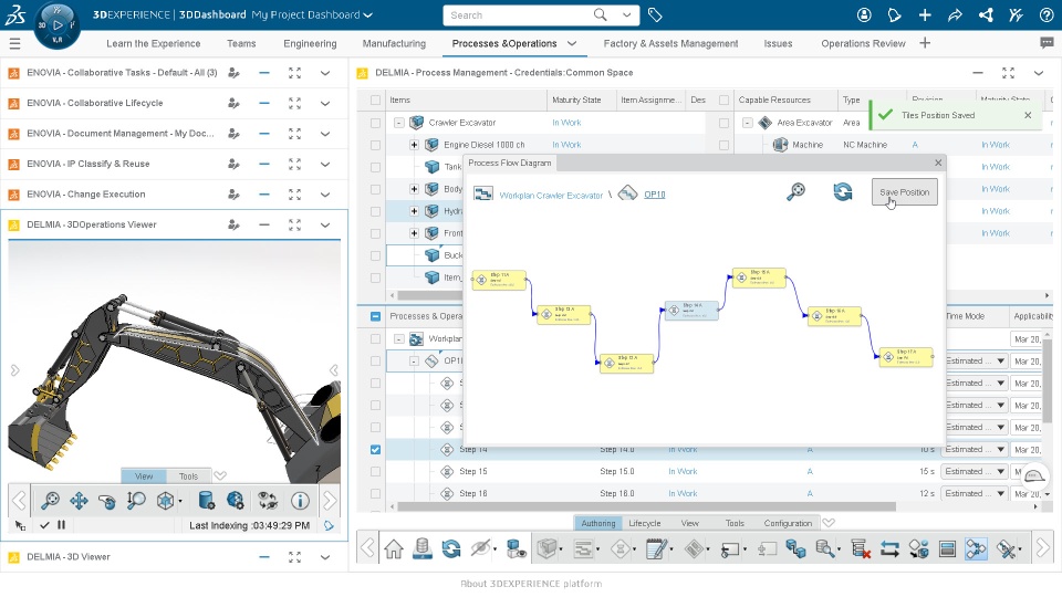

Increase process definition speed and efficiency by easily authoring a process plan with new Process Flow Diagram enhancements, including advanced layout options.
Massive operations on Mfg Items objects :Dedicated user interface to list all retrieved instances and manage individual update actions (ignore, remove, add, replace by new reference, new revision, new branch or existing item)
Improve Process data capabilities by visualizing the precedence network (Process Flow Diagram) through a dedicated user interface with tiles layout saving capability
Support alternative paths in the process sequence by defining different types of product flows with associated reason codes (displayed with different colors): - Good (default) - Alternative - Scrapped - Failed
