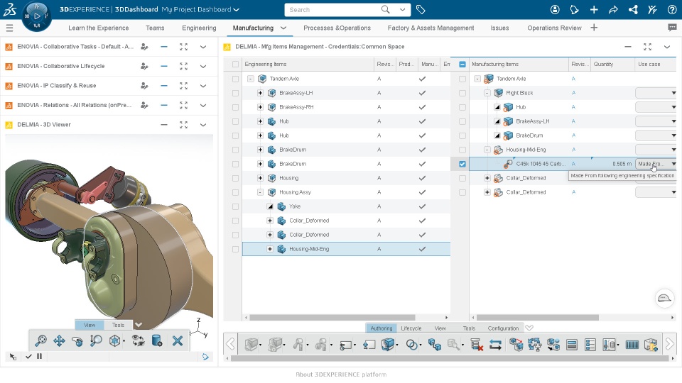

Easily manage multiple updates (replace by, remove, add) by applying the same modifications for multiple instances of Manufacturing Items, on a given reference, using a single user interface.
Raw Material specification with or without quantities (for discrete or non discrete Raw Materials) will be managed within the Product structure and exposed to Manufacturing with a new relation (“Made From” for a Product to refer to another Product / Raw Material item)
The Raw Material information will be leveraged and mapped within the Manufacturing Items structure either: - as a Provide for discrete Raw Material - or as Continuous Manufacturing Items with quantities for non discrete Raw Material. In that case Continuous Provide and Raw Material (or Product) will be automatically linked with a scope

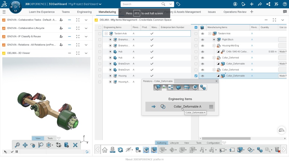

Deformed part will be managed within the Product structure and exposed to Manufacturing with a new relation (“Deformed from” for a Product to refer to another Product)
This deformable/deformed parts information will be leveraged and mapped with a Mfg Item automatically linked with a scope to the deformable part and with a traceability link to the deformed part

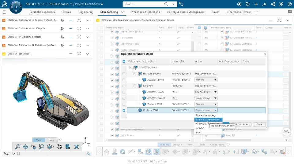

Massive operations on Mfg Items objects :Dedicated user interface to list all retrieved instances and manage individual update actions (ignore, remove, add, replace by new reference, new revision, new branch or existing item)
