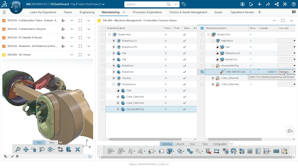

Define, validate and release a consistent Manufacturing BOM for any downstream usage such as ERP and MOM, by supporting “As required” for continuous quantity and map it with Engineering specification.
Raw Material specification with or without quantities (for discrete or non discrete Raw Materials) will be managed within the Product structure and exposed to Manufacturing with a new relation (“Made From” for a Product to refer to another Product / Raw Material item).

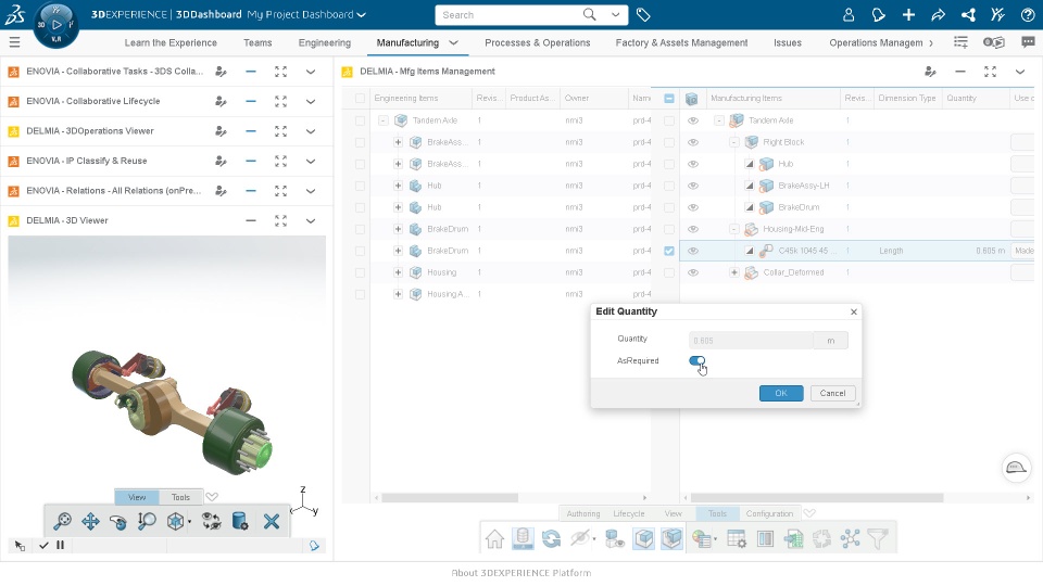

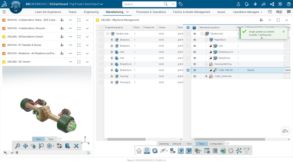

New 'As required' option for continuous quantity management.
It is now also possible to do it on Continuous Manufacturing Items, with a new check box “As required” available at quantity edition. This “As Required” quantity is also automatically mapped when generating Continuous Manufacturing Items out of Raw Material linked with Make From relationship on EBOM side with a quantity also specified “As Required”.
