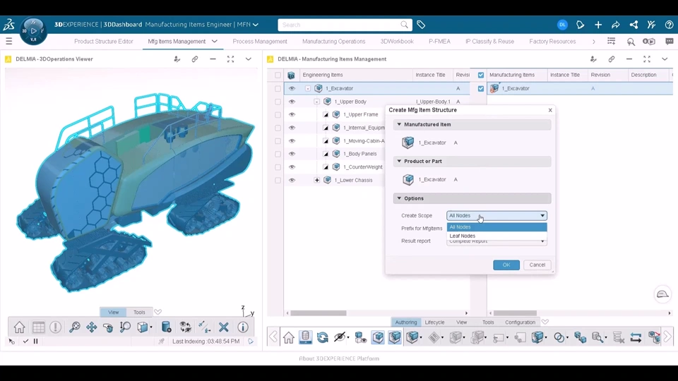

- Automate non-value-added user interactions to streamline the process engineering definition by introducing the "Create MBOM from EBOM" command in the Manufacturing Items Management widget. This automation reduces manual input and accelerates the process for improved efficiency.

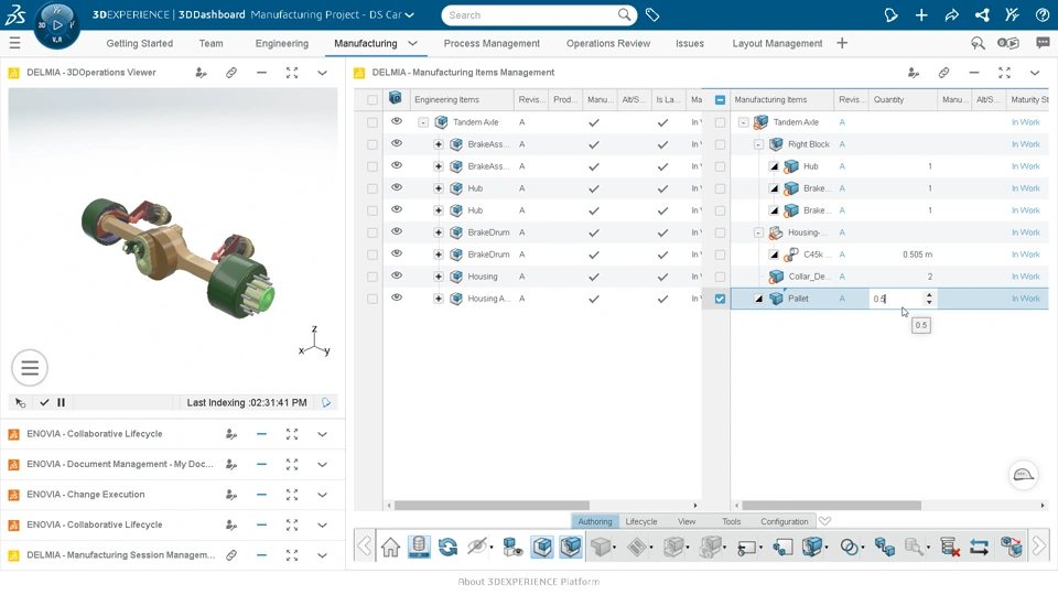

- Simplified and improved quantity management on discrete items by specifying:
* non-integer quantities to manage items splits
* integer quantities greater than 1 for items used in large quantities

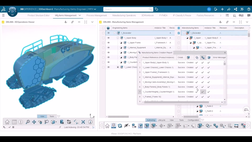

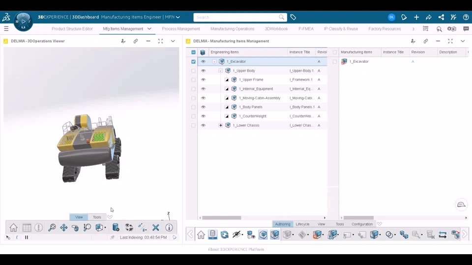

Automatically build up an MBOM from an existing product structure on the Cloud.
Manufacturing Items & Assemblies are generated automatically from the Product Structure.
A report appears after the automatic creation ends to dashboard the creation status and display generated relationships for each manufacturing items.

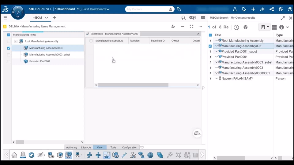

Manufacturing specific alternates are valid independently of the context . However, manufacturing substitutes are valid in a specific context and are defined only for a specific instance. Manufacturing substitutes provide a different way to produce and include a list of all the parts and their quantities required to build the product.

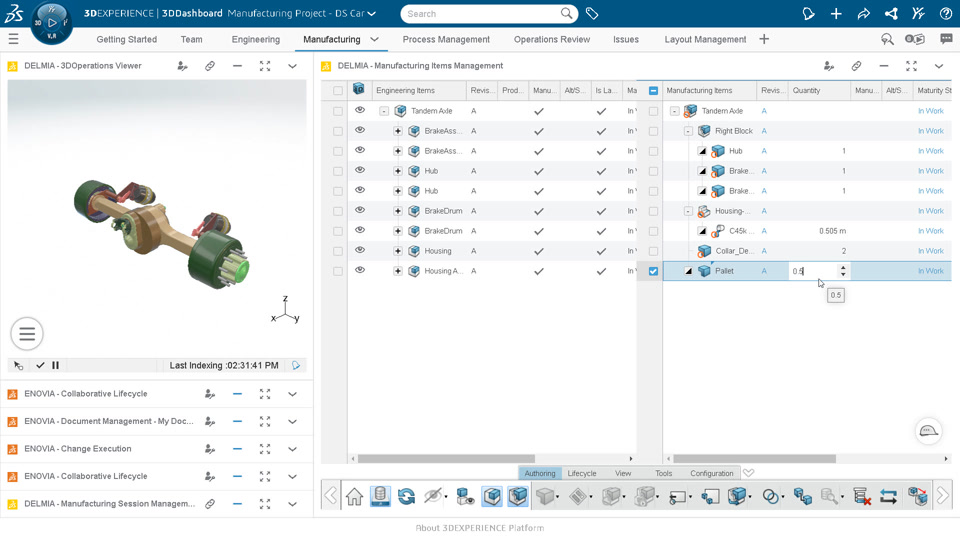

Set a ratio of discrete quantity in the similar way as for continuous items, without having to manage discrete items by instances.

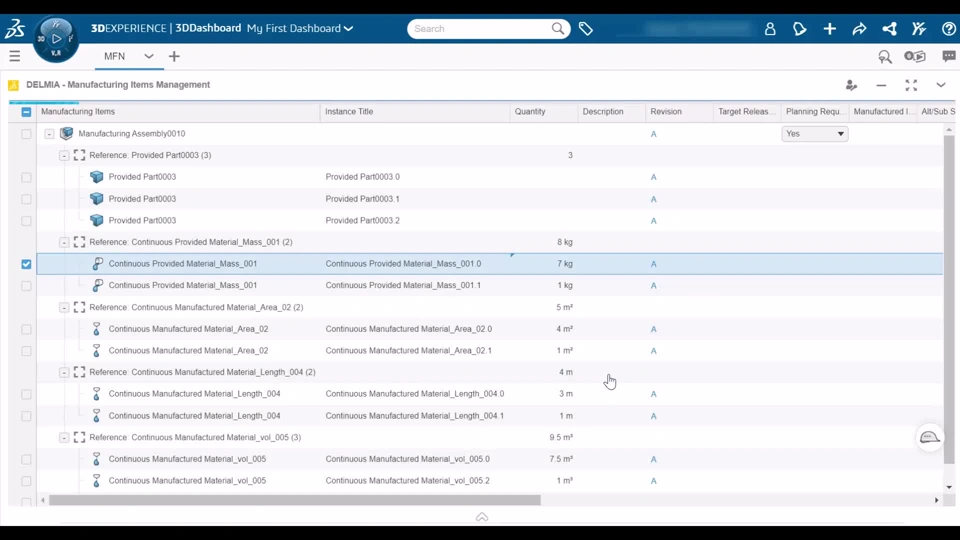

Rollup quantity in the widget spreadsheet for both discrete and continuous items. When the manufacturing items structure is grouped by reference, the quantity column displays: - The sum of all quantities of reused continuous item with magnitude (Continuous items) - The count of instance reused discrete item without magnitude (Discrete Items).

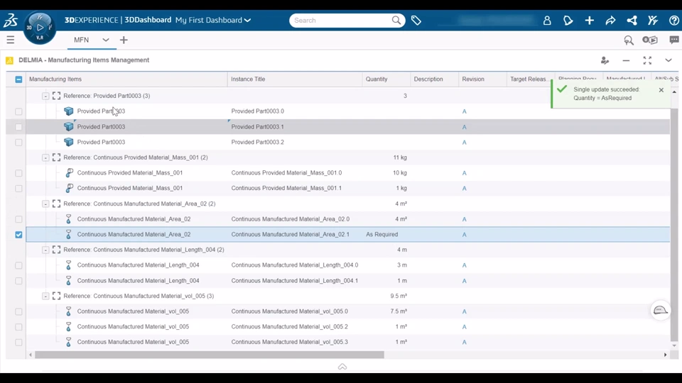

“As required” counted as zero in the quantity roll up mechanism.
