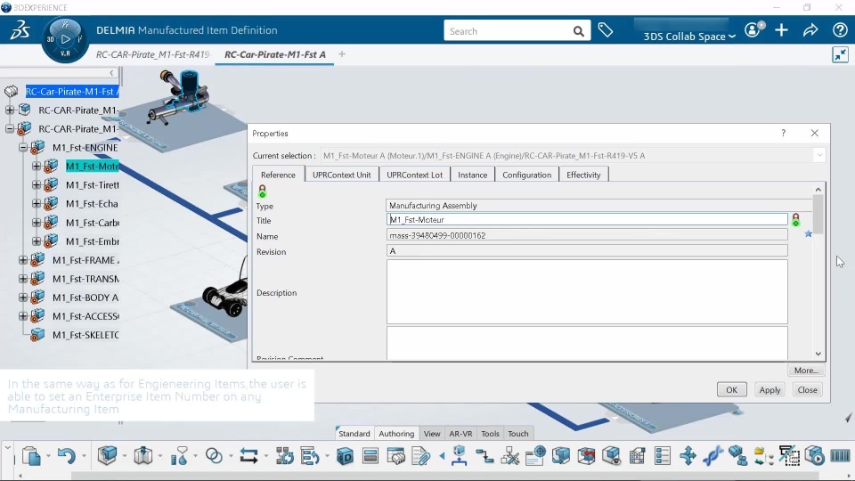

- Define unique part numbers for Manufacturing-specific items similar to Engineering Items with dedicated attributes (Enterprise Item Number)
Ensure consistent Process data update mechanisms to avoid non value-added actions and unnecessary data creation
- New strategy proposal to consume new items without having to evolve the impacted process step

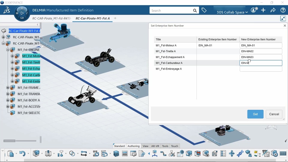

As for Engineering Items, an Enterprise Item Number (EIN) can be set on Manufacturing Items.
A new dedicated command is available in Process Engineering authoring apps to set and edit EIN on selected Manufacturing Items

AR
AR 2023-05-23
​@AB  - thanks for great feature for adding EIN in Manufacturing items but in 23x FD02 we see for product we can make it Unique but for manufacturing items there is no option to set Uniqueness. Moreover   in product side we can generate Number for multiple item with single action but in Manufacturing side (PPL and MFN) no option to generate sequence for multiple items
