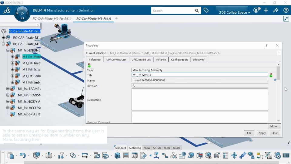

- Define unique part numbers for Manufacturing-specific items similar to Engineering Items with dedicated attributes (Enterprise Item Number)
Ensure consistent Process data update mechanisms to avoid non value-added actions and unnecessary data creation
- New strategy proposal to consume new items without having to evolve the impacted process step

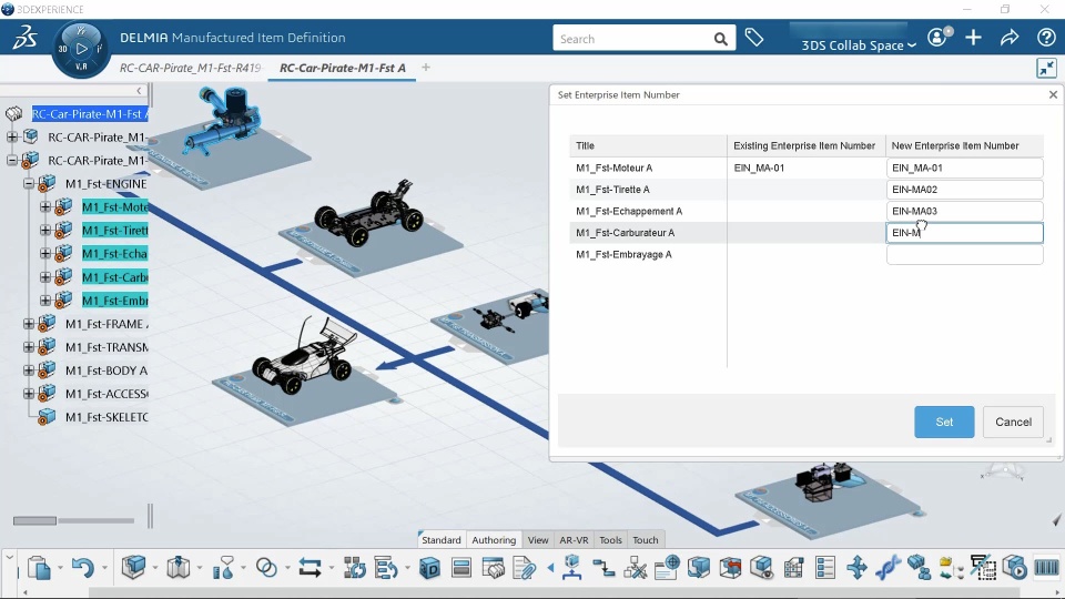

As for Engineering Items, an Enterprise Item Number (EIN) can be set on Manufacturing Items.
A new dedicated command is available in Process Engineering authoring apps to set and edit EIN on selected Manufacturing Items
