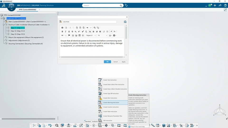

- Deliver enriched authoring capabilities to meet requirements from service/maintenance process by managing dedicated sub-types for Warning, Caution and Notes.

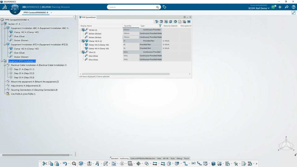

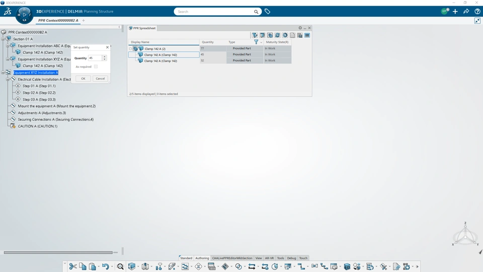

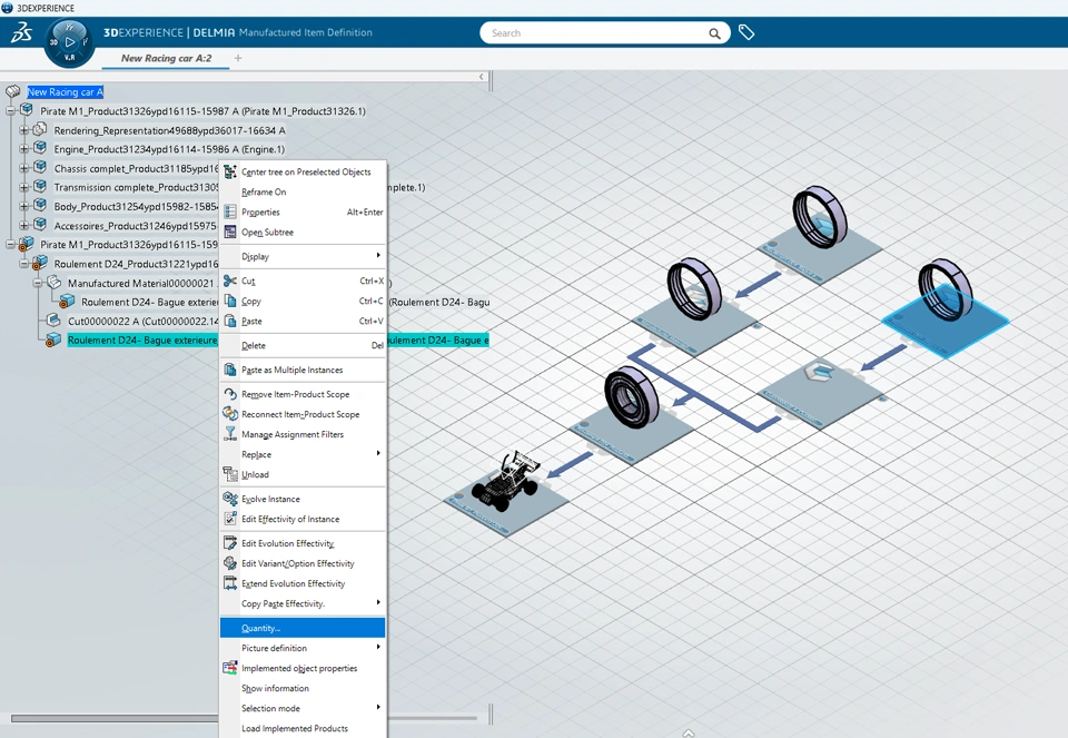

- Simplified and improved quantity management on discrete items by allowing to specify:
* non-integer quantities to manage items split (e.g. for molding)
* integer quantities greater than 1 for items reference used in large quantities

- Enhanced Manufacturing BOM review and reporting capabilities within the PPR Spreadsheet view by automatic roll up quantity computation for continuous items as well as for discrete items
New capacity to create different types of Alert (Warning, Caution, Note) for specific downstream distinct usage (eg. different level of priority or different user exposure)
New capacity to define quantity on discrete items for multiple items of the same reference without requesting an instance for each (eg. no 3D and high quantity)
New capacity to define a non integer quantity for items split (eg. 0.5 as half of part cut in two pieces)
Rollup quantities for both discrete and non discrete items in PPR Spreadsheet
