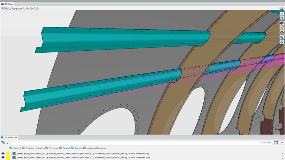

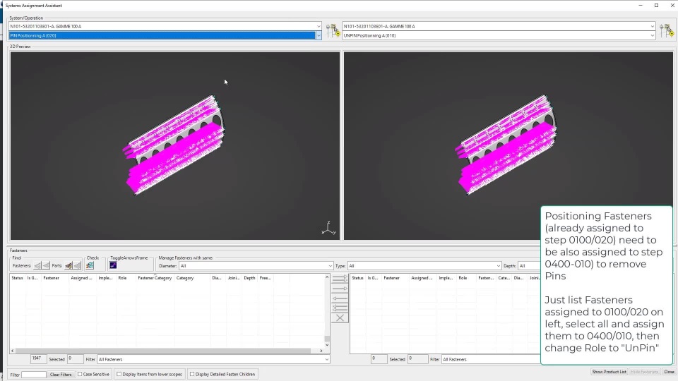

Manage complex fastener assembly process definition :
- Ability to associate detailed manufacturing fastening strategy (eg. manage pre-drill and drill, fastener constituents...) for each fastener on a given bundle and provide the right granularity to define associated Work Instructions
User Experience Value
Enhanced virtual build experience provides the ability to display symbolic fastener representations in the 3D main window.
Detailed fastening strategy management for Fastener Bundles between EBOM and MBOM
Process video (MBOM video posted 2 times by mistake)
3D symbolic fastener representation when applying 3D product build up
