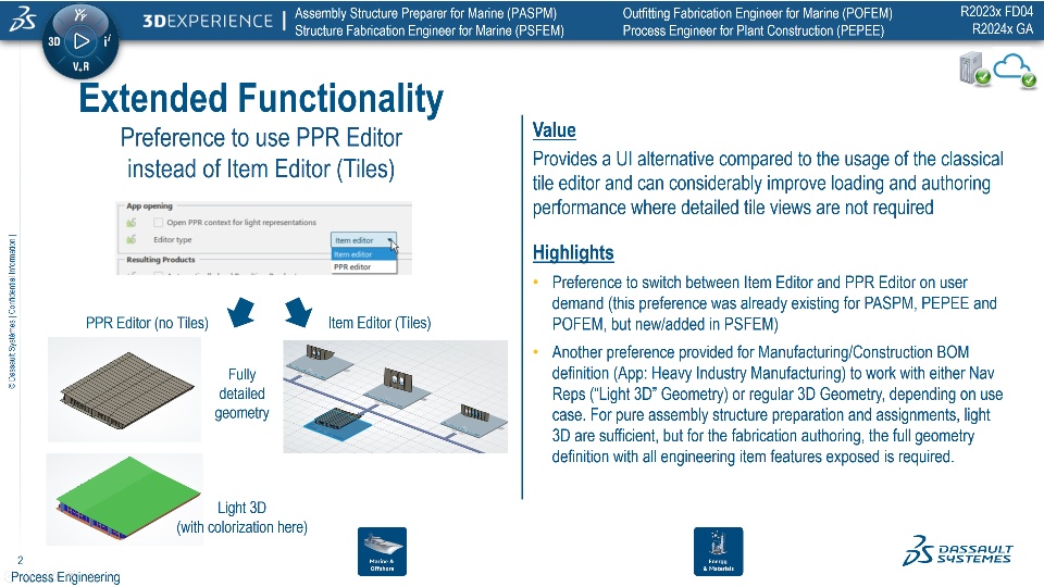

To benefit from better usage performance on large data sets, it is recommended to use PPR Editor instead of Item Editor (Tiles).
This enhancement supports the usage of both Navigation Rep as well as Authoring Rep in the PPR Editor (was so far limited to Nav Rep mode only).

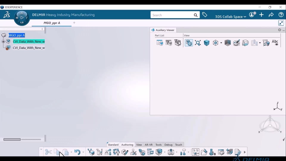

Updated user preference to control how to open product data and in which editor (video)
Updated user preference to control how to open product data and in which editor (details)
