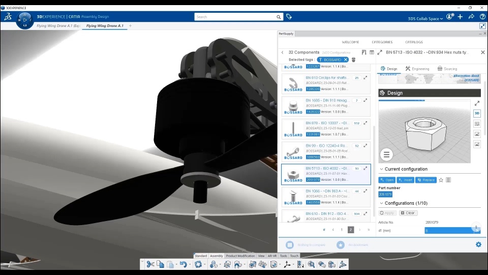

Will this inserted part get automatically into the CommonSpace CollabSpace?
What about the naming? Wanted: E.g. D912 M6x12 Not wanted "2536485345". But to be honest, I have not checked it with FD01. If the naming is not defined, then it may end in a mess, because users often do not rename it or do not delete the unwanted data
BT
BT2022-02-23
@AB trying to open or insert any parts results in the error "UNABLE TO IMPORT DATA."
