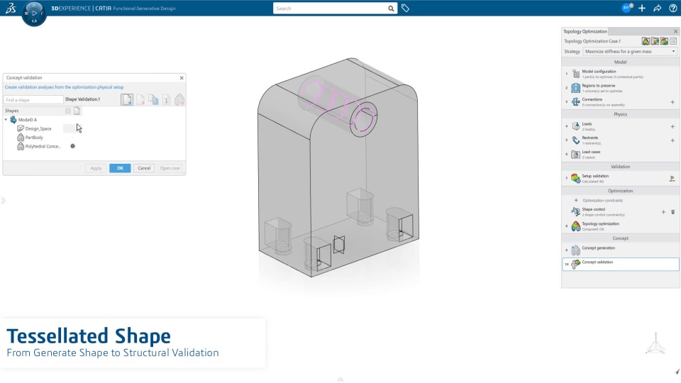

End to End video illustrating all highlights in R2022xFD01 with the new load case manager, the structural validation of the tessellated shape and the multiple generation command.

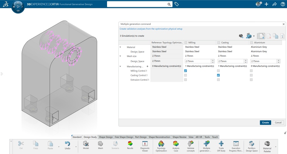

Image illustrating the improved Generative Design variant creation capabilities to explore new designs by managing optimization setup such as material, mesh size or the manufacturing constraints in a simplified and guided experience.

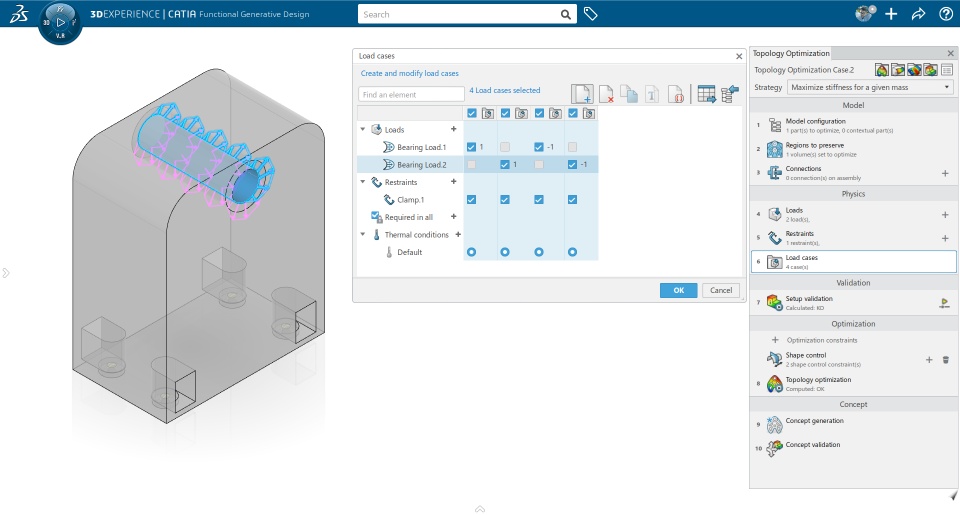

Illustration of new load case manage command that provides an easier and more efficient load case management, scalable to a large number of load cases, including export/import cases capabilities.

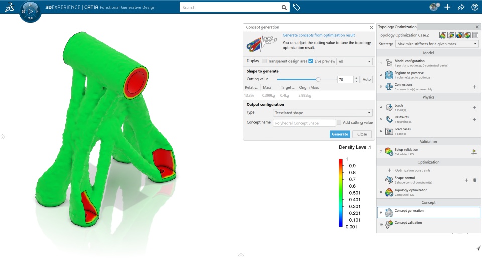

Image of the Generate Shape command with the tessellated shape output configuration that can be reused as support for design reconstruction (such as Imagine and Shape or the Milling Assistant) and structural validation.

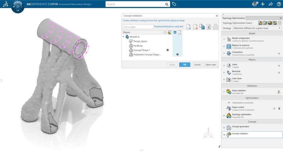

Illustration that shows the capability to consume a Tessellated Shape into the Concept Validation command with a seamless integration of the different loads, restraints and mesh specifications from the optimization case.

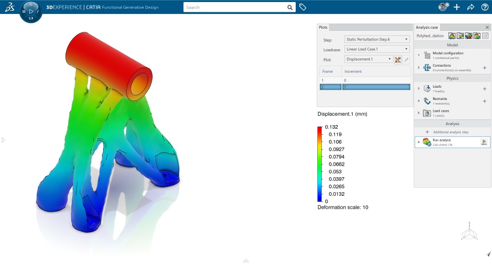

Image showing the structural validation results based on the tessellated shape from the generate shape command.
