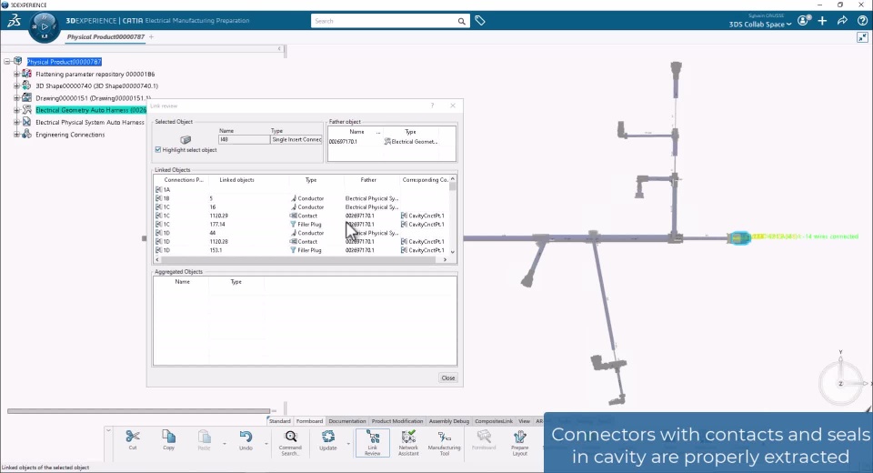

Two new patterns are now handled:
- Multiple components linked to a single connector cavity
- Backshell to backshell assembly pattern

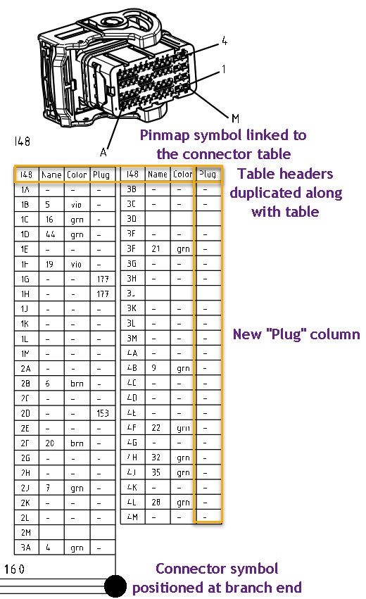

- Connector information improvements:
- New column for plugs inserted into empty cavities
- Pinmap symbol now linked to the table
- Connector symbol can now be positioned at the branch end even if its real position is far
- All drawing items with blank background by default

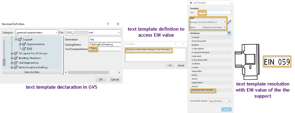

- Display EIN number of a support
- Instantiated symbols keep their original reference size
- Table report headers can be duplicated
- and more

Various Drawing Enhancements
Enterprise Item Number Integration
