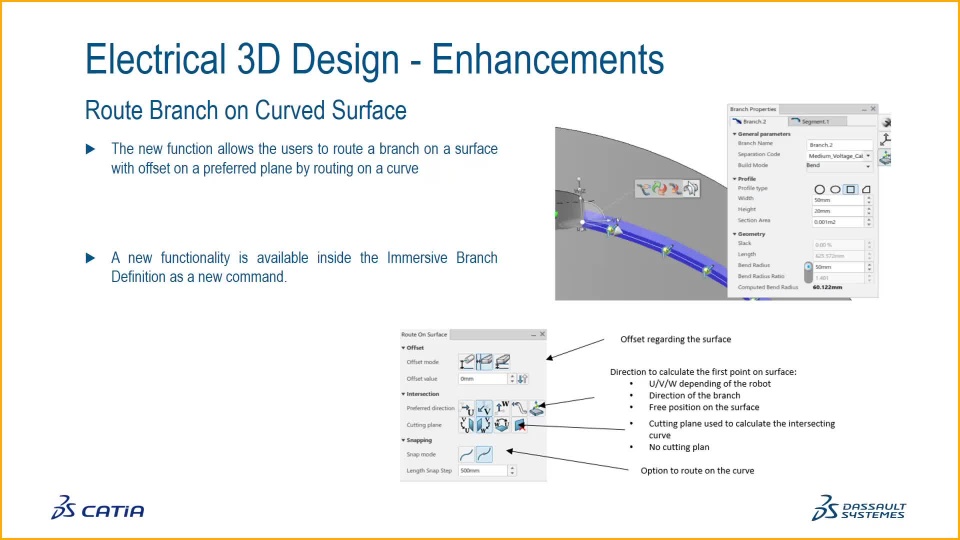

1. Separation codes used for configuration is also added as a generic attribute in branch geometry properties. It can be defined at creation providing increased control and flexibility while creating 3D cable routes
2. Enhancement of the branch routing immersive tool to allow for more control while routing around complex curved surfaces. The user can now define a plane to be followed and increase routing ease and precision

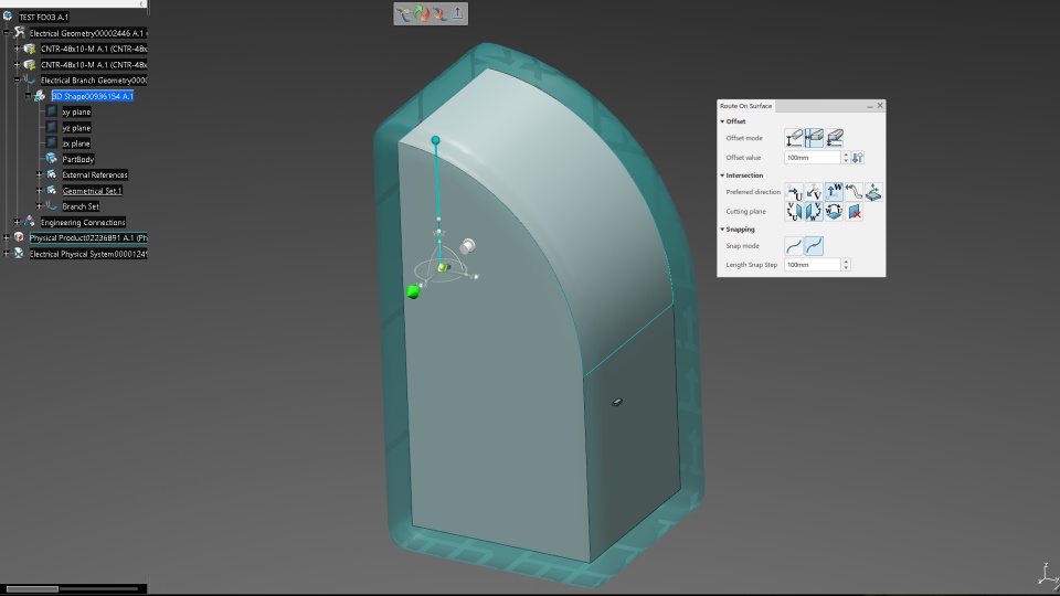

Preview of the first routing point with the intersection of the preferred direction and the offset surface

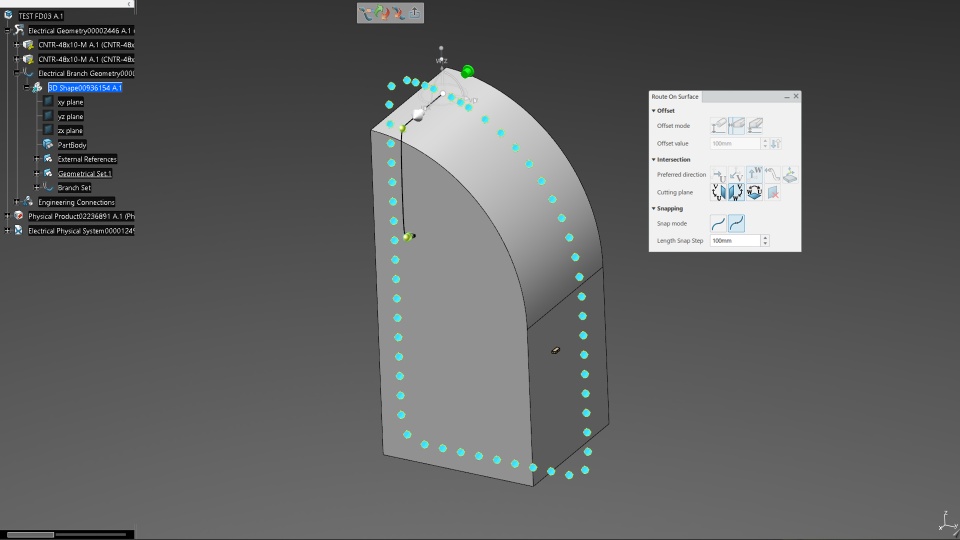

Intersecting Curve generated with the intersection of the preferred plane and the surface
