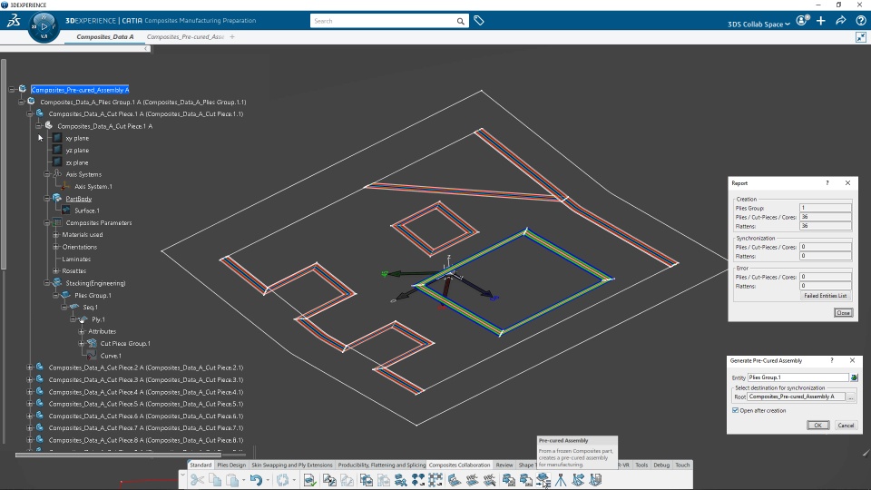

1. Integration with DELMIA Manufacturing Planning: a new command allows the generation of product structure model generated from a frozen composites part, corresponding to pre-cured assembly of composites part.

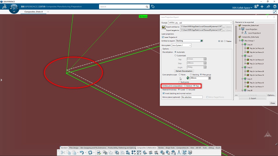

2. Laser projection option to export the top or the bottom edge of plies i.e. the laser path either displays where to put the ply on the mold (bottom edge) or displays the top of the ply once already laid onto the mold (hence the top of the edge).

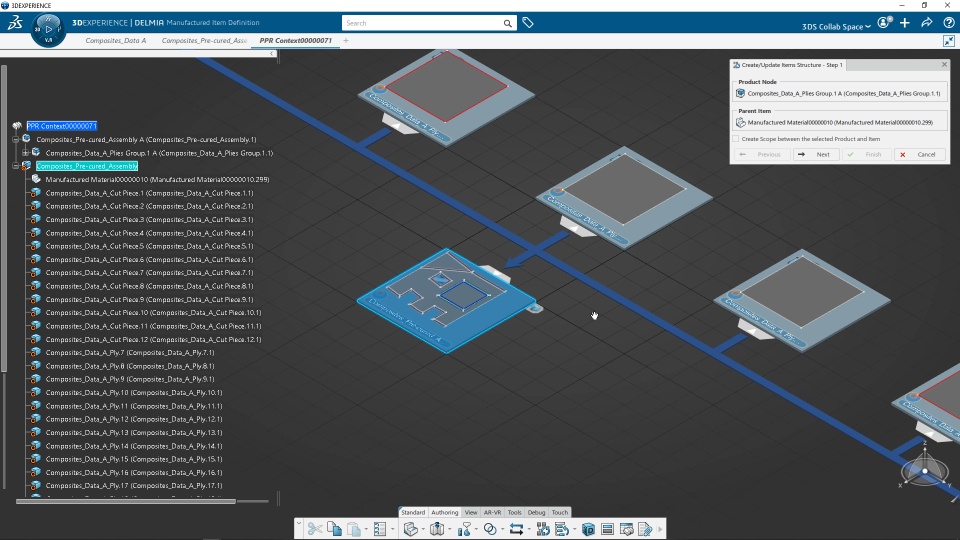

Create product structure model from a frozen composites part, corresponding to pre-cured assembly of composites part

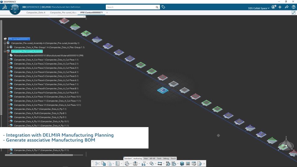

- Integration with DELMIA Manufacturing Planning - Generate associative Manufacturing BOM
Option to export top or bottom edge of plies i.e. the laser path either displays where to put the ply on mold (bottom edge) or displays the top of ply once already laid into the mold (top edge)
