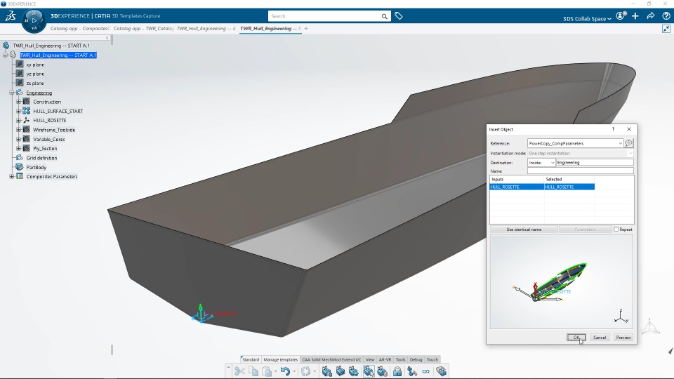

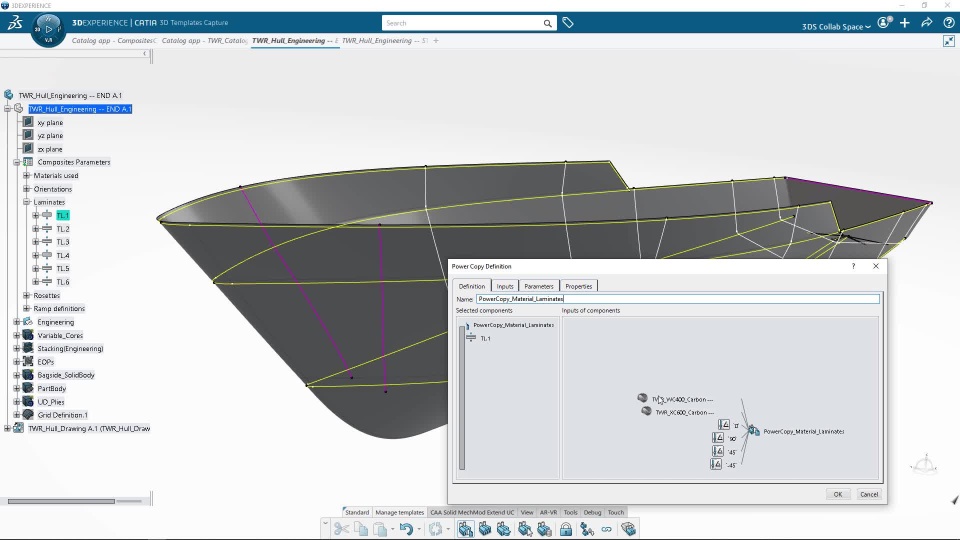

Power Copy of Composites Parameters: enables the creation and reuse through catalogs of the whole Composites Parameters or specific feature of the Composites parameters (only the following specific features can be used as input of the power copy: materials, laminates – thickness laws & stacking sequences, rosettes and ramp definitions).

Create Power Copy of materials, laminates, ramp definitions or the entire Composites Parameters from an existing design and instantiate it in a new design

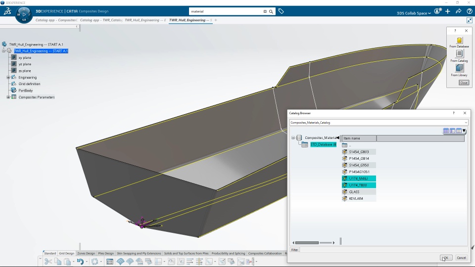

Select and add composite materials from a classified structure like a Catalog or a Library

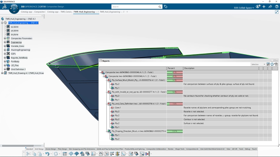

Design quality check rules to meet design processes and quality standards
