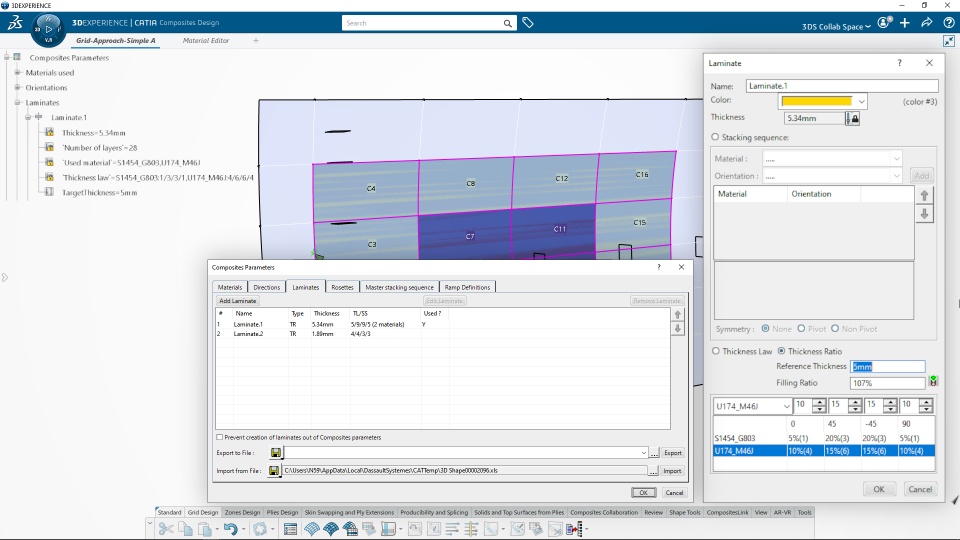

Laminates in the Composites Parameters can now be defined with a targeted thickness and corresponding ratio per orientation. The targeted thickness is exposed as a knowledge parameter.

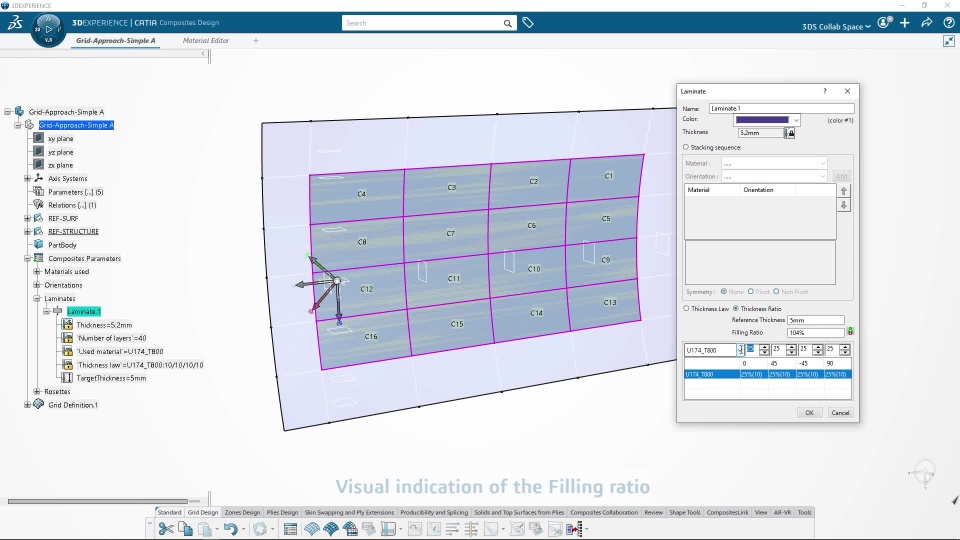

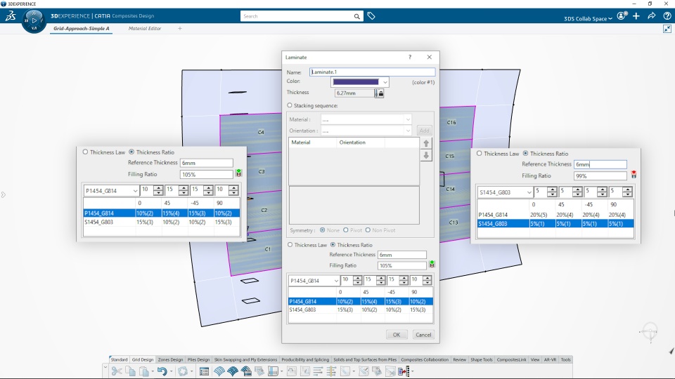

Define laminates based on the conceptual reference thickness value by assigning ratios for each orientation per material.
Automatic computation of the number of layers based on reference thickness along with visual indication of the thickness achieved.

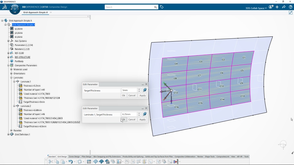

The thickness law, number of layers, and actual thickness all update automatically when the target thickness parameter is changed, making Composites conceptual design exploration quick and easy.
