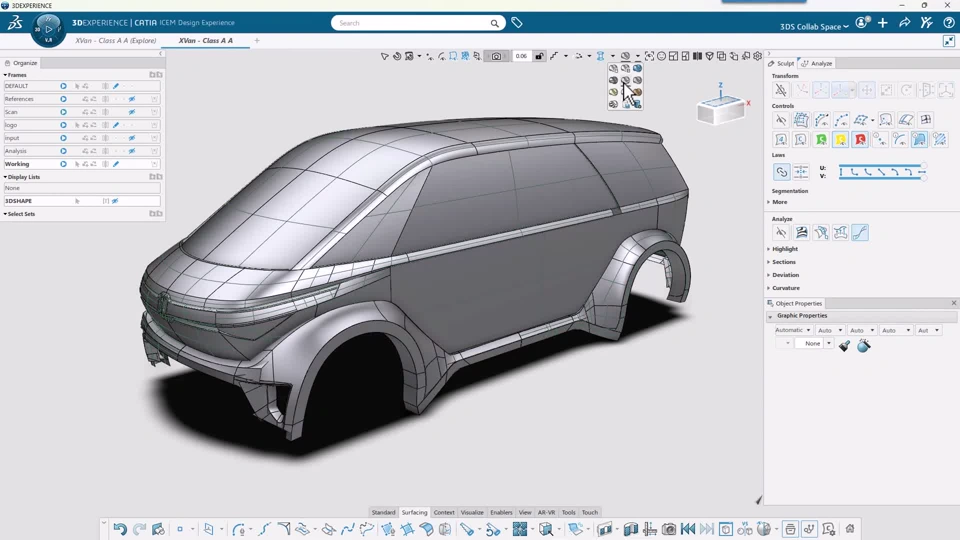

Enjoy the latest updates for ICEM Design Experience which significantly enhance usability and surface modeling quality. Users benefit from a more intuitive interface with redesigned icons, expanded menus, and centralized controls, making navigation and tool access faster.
What was already delivered with 3DX-R2025x FD01
What is additionally provided with 3DX-R2025x FD02

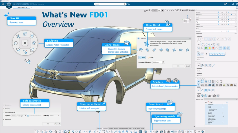

Enjoy a more intuitive and modern interface with fully redesigned icons, making it easier to identify and use tools efficiently (FD01).

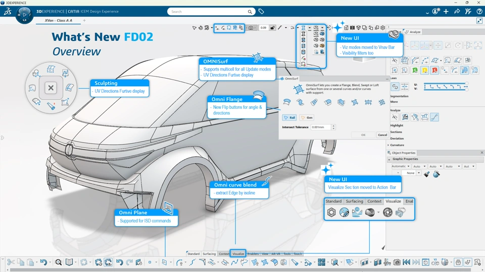

Centralized V-Nav Bar: Focus on your design with a streamlined V-Bar that removes unnecessary Rotate/Pan/Zoom options, reducing clutter and improving usability, and easily access pre-defined shaders, visualization modes, and visibility filters directly from the V-Nav bar, enhancing your design experience. Optimized command lay out: find all ‘Visualize’ commands conveniently located in a new section of the Action bar, making it faster to switch between different visualization modes.

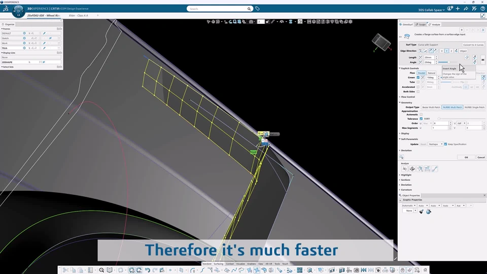

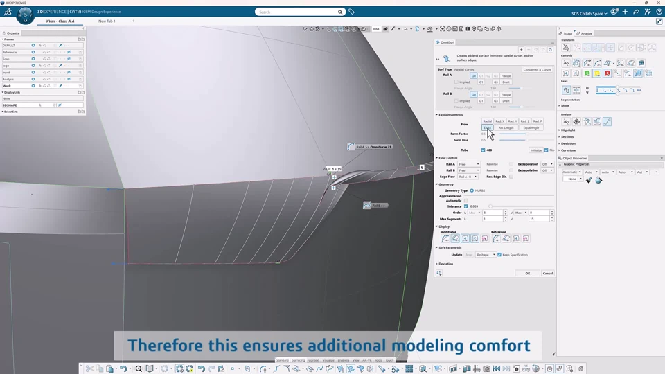

Enhanced UI: Manage Flange length/angle values and revert directions with a new, user-friendly interface, making complex surface adjustments simpler and more efficient.

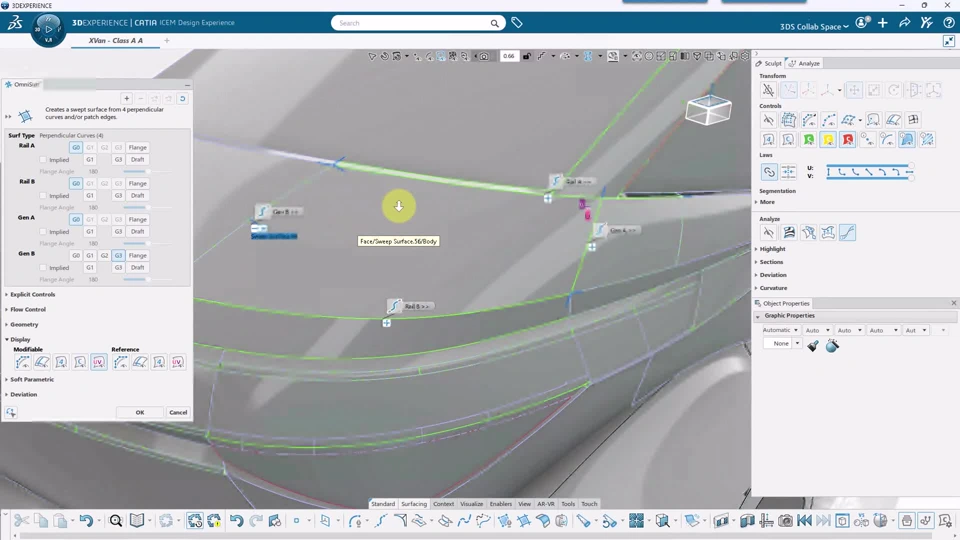

GSD/ISD Feature Support: Utilize OmniPlane as a plane or direction in GSD/ISD features, providing more flexibility and precision in your surface modeling.
Multi-Cells Situations: Ensure high-quality surfaces with condition checks and measurements for multi-cells situations, reducing errors and improving overall design integrity.

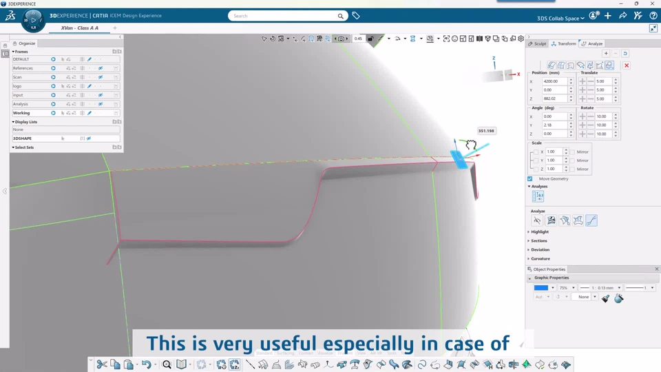

Furtive Display of U & V Directions: Gain better control over your fillet design with the furtive display of U & V directions, providing clearer visual feedback.

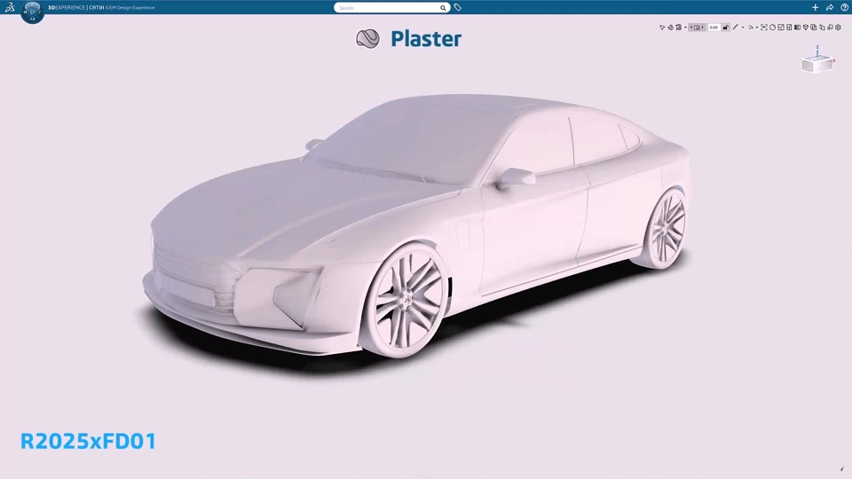

Improved Satinated & Plaster Shaders (FD01): Enhance your visualization with improved ground shadows, backplate, and lighting for Satinated and Plaster shaders, providing a more realistic and professional design presentation
