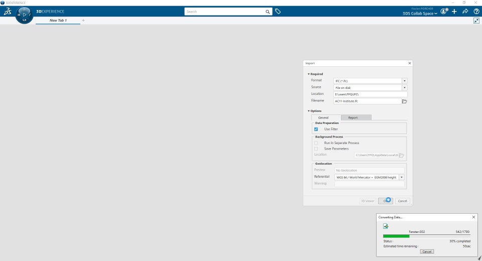

1.Increase collaboration by importing IFC models 'for design', this new import mode allows IFC models to be filtered and grouped inside Geometrical Sets inside 3DShapes. Importing a model 'for design' retains all relevant attribute information for each object without creating unique objects in the database for each IFC element imported, reducing import time significantly

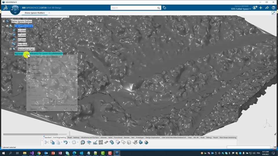

2.Reduced import and extract time for large point clouds through use of a bounding box or when using a new slider to assist in controlling the filter options before terrain meshing

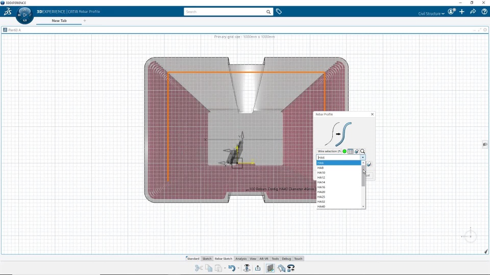

4.Increase structural modeling coverage to include the reinforcement of concrete reinforcing bars

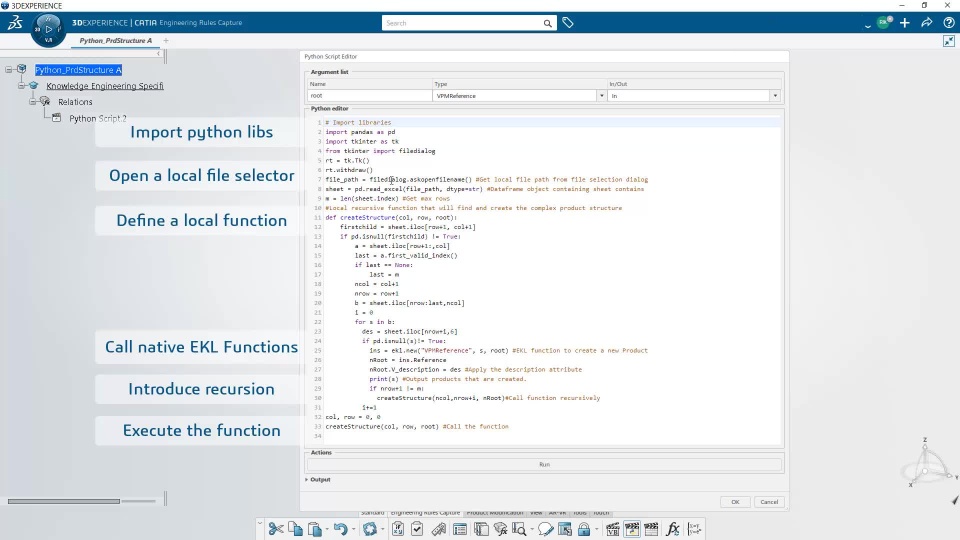

5.Increased accessibility and functional coverage for design automation scenarios by providing scripting capabilities using Python language with access to native EKL functions

Increase design productivity by modeling rebar groups using out of the box bar templates
Increase collaboration by importing IFC models 'for design', this new import mode allows IFC models to be filtered and grouped into 3DShapes as feature objects (as opposed to CGR 'for coordination' or PLM Assembly 'for construction'). Importing a model 'for design' retains all relevant attribute information for each object and exposes the geometry for downstream design and engineering processes without creating unique objects in the database for each IFC element imported, reducing import time significantly.
