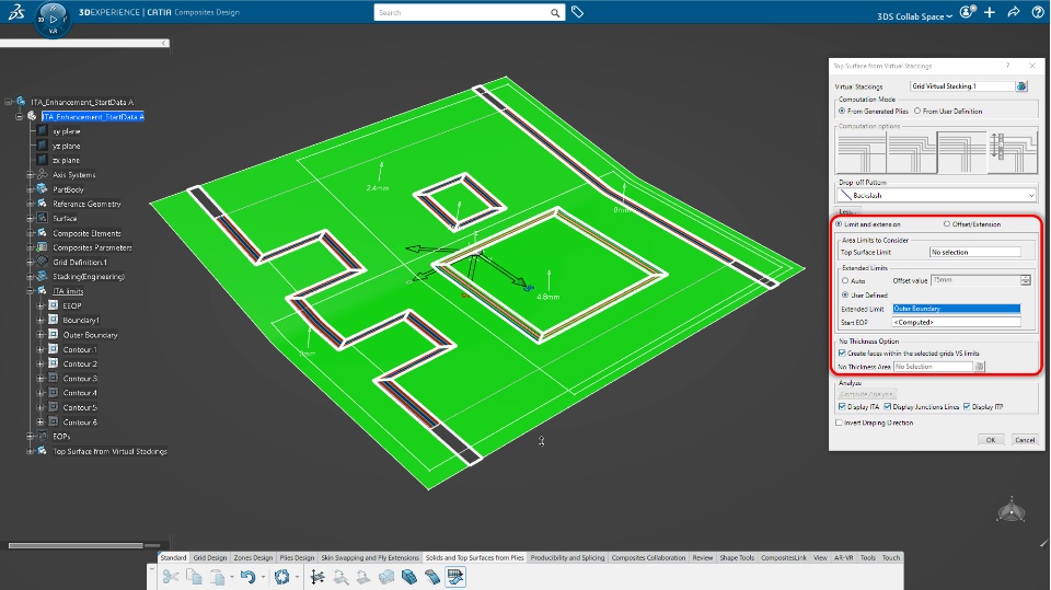

1. Top Surface from Virtual Stacking enhancements (Extended Limits, Local Areas Creation, Zero Thickness Areas)

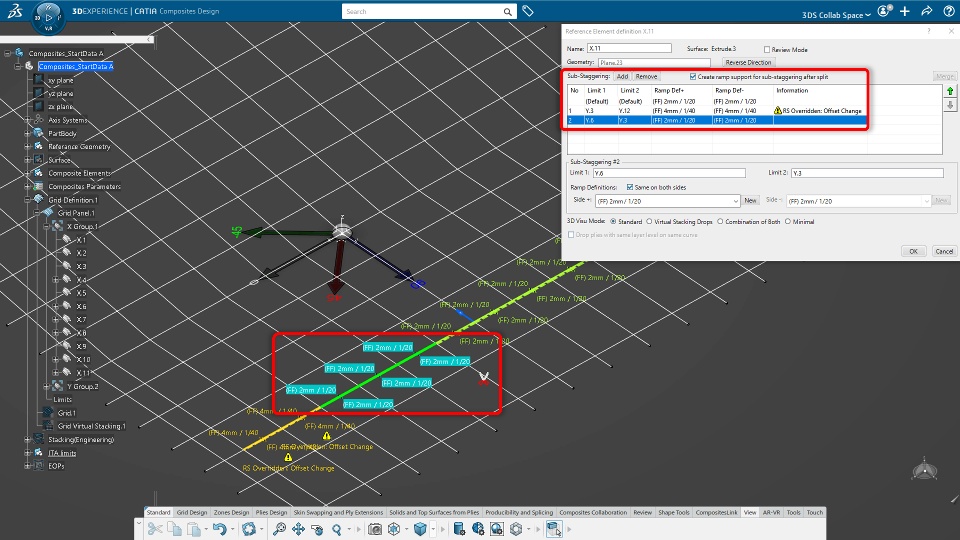

2. Sub-stagger definition is kept when a sub-stagger is split

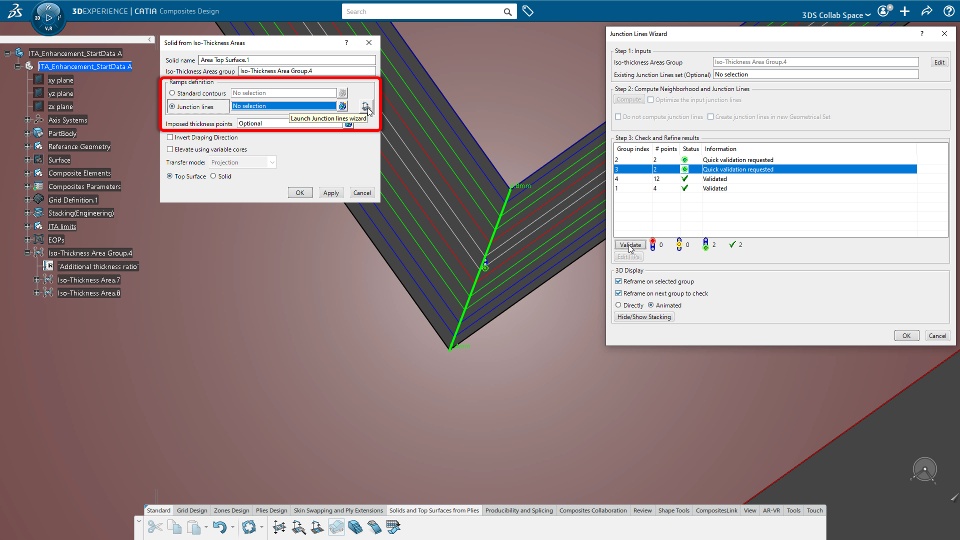

Integration of Junction Lines wizard in the Top Surface from Iso Thickness Area Command

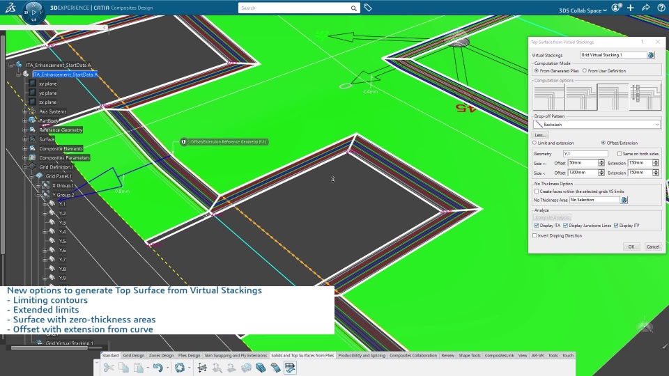

New options to generate Top Surface from Virtual Stackings:
- Limiting contours
- Extended limits
- Surface with zero-thickness areas
- Offset with extension from curve
Integration of the Junction lines wizard in the Solid from Iso-thickness Areas command
Ramp definition, drop off definition and local overrides of existing sub-stagger of reference element will be retained after split
