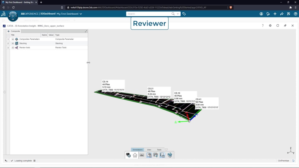

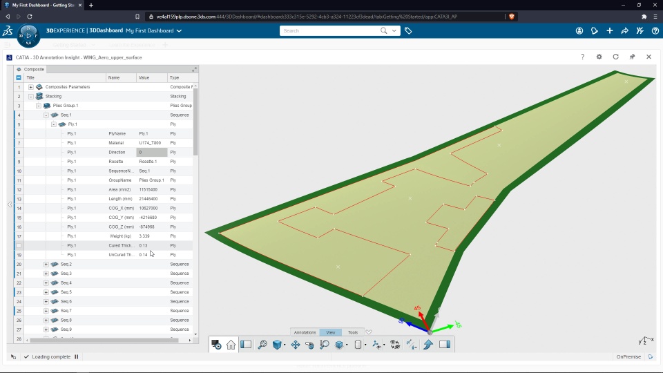

Composites data now available for review in the 3D Annotation Insight Widget (Plies, 3D Sections, Core Samples, Rosette, Numerical Analysis …)
1. Ability to visualize and review composites data at all stage of the engineering process (design and manufacturing data) in the 3D Annotation Insight Widget
2. Ability to visualize all required composites information for manufacturing in the 3D Annotation Insight Widget (can advantageously replace the need for time-consuming ply books creation)

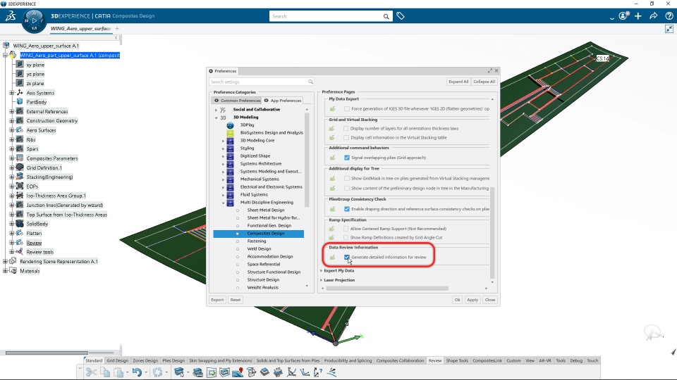

New option under Preferences to generate detailed information for review

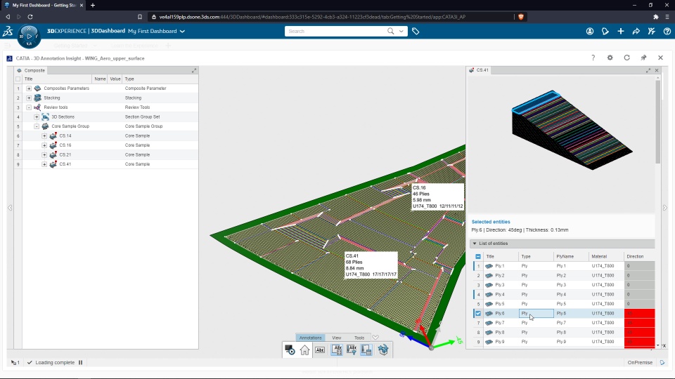

Review Core samples in detail from within the web widget
Visualize and review Composites information (Plies, 3D Sections, Numerical analysis, Core samples...) in the web widget
