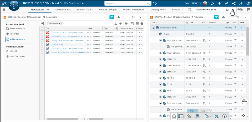

3DSearch
Search Dropdown Enhancements
  • You can now use the revamped, user-friendly search dropdown, offering additional features like clearing your search history
  • Access the "Switch to Previous Version" option in the dialog box for a seamless transition to the old search UI
  • Utilize the "Search in Tab" option to efficiently search across all apps and save time

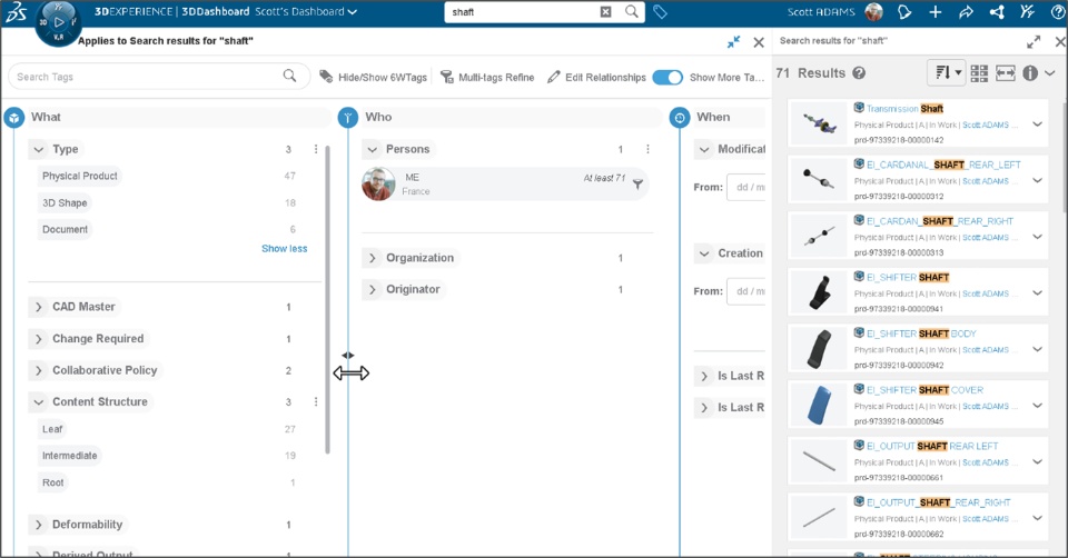

Maximized 6WTags Panel
  • In the 6WTags panel, the new “Maximize” button is provided that lets you maximize the panel for increased space, seamless navigation and eased tag selection
  • The 6W sections are arranged in a horizontal layout, allowing you to scroll through them by dragging
  • You can also manually increase the width of a specific section for a detailed view

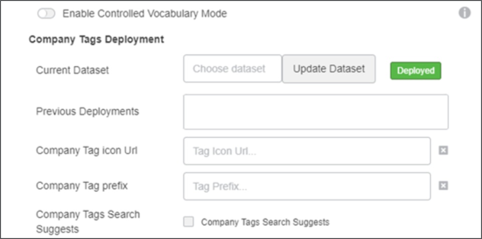

Company Tags and Controlled Vocabulary
  • The Company Tags Deployment section allows you to select and define the ontology that contains the display tags in the Company Tags category of the 6WTags panel.
  • You can also select the “Enable Controlled Vocabulary Mode” check box to allow users to only create Company and Community tags
  • Once deployed, your company tags are available to all users in the 6WTags panel.
Prerequisites:
  • The Company Tags Deployment option in the 3DSearch Control Center is available only with the Data Steward license role.
  • Users need the Collaborative Industry Innovator role to use company tags from their own 6WTags panel.
