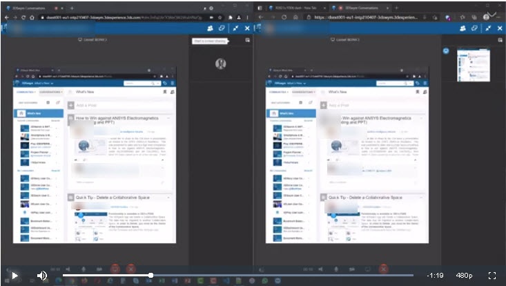

Conversations

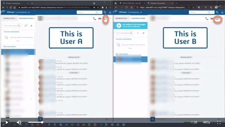

Some great news about Conversations, they now support screen sharing in audio and video calls. Let's not wait any longer and let me show you how this works!
Screen sharing is currently not supported on iOS, Android and Internet Explorer. It is recommended to use Google Chrome or Microsoft Edge
Additionally, your conversations' list is now sorted by recent activities.

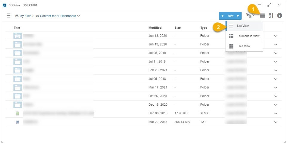

List view as a new layout in the 3DDrive widget
This new view allows you to display one content by row with properties displayed in columns. There are 5 default columns in this view (title, type, size, modified date and creator). Depending on the size of your widget, the columns can become hidden. This view support Drag & Drop.

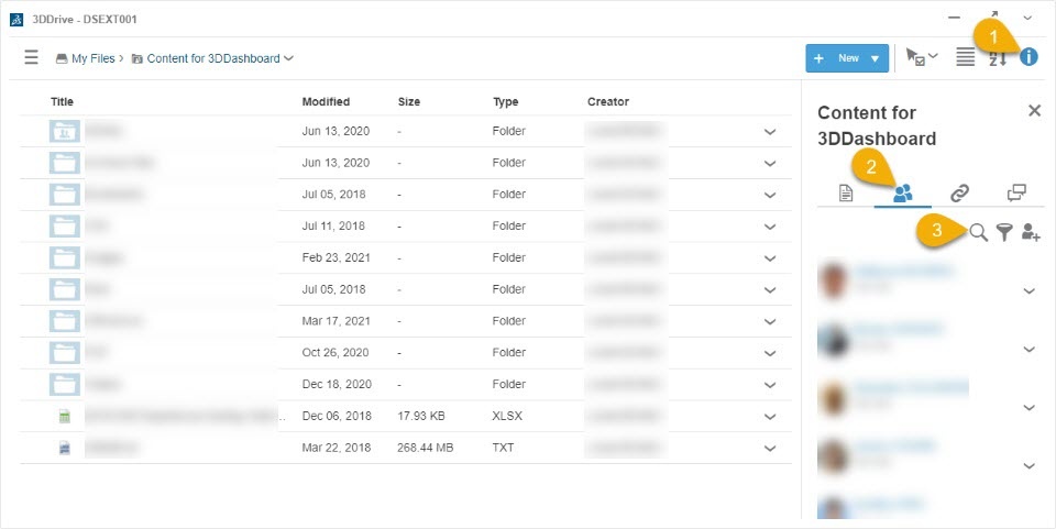

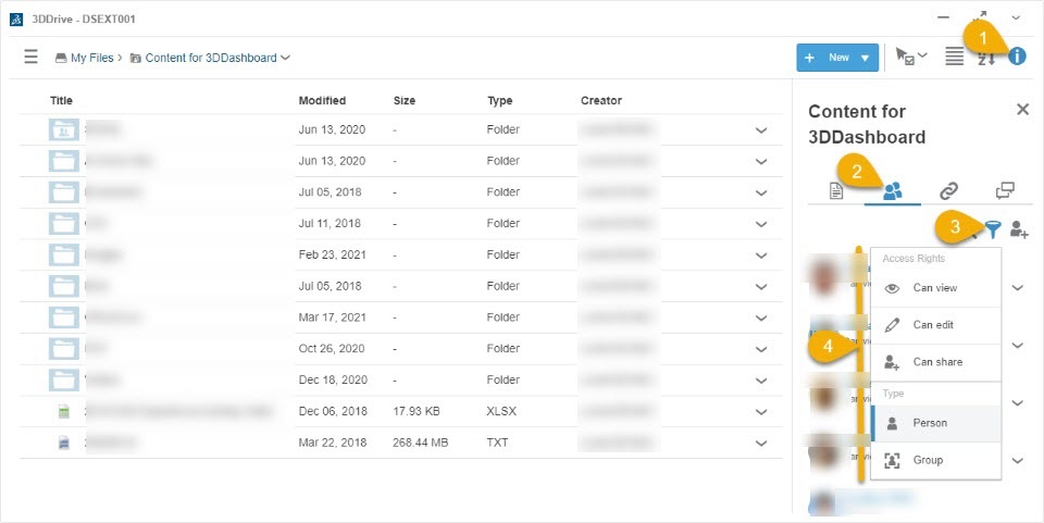

Search and Filter Members
On a shared content (from access tab) you now have the capbility to:
  • Search by members
  • Filter by Access Rights or by Type

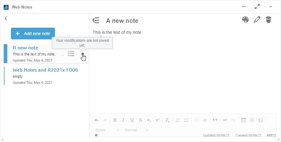

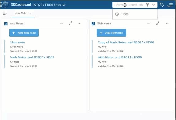

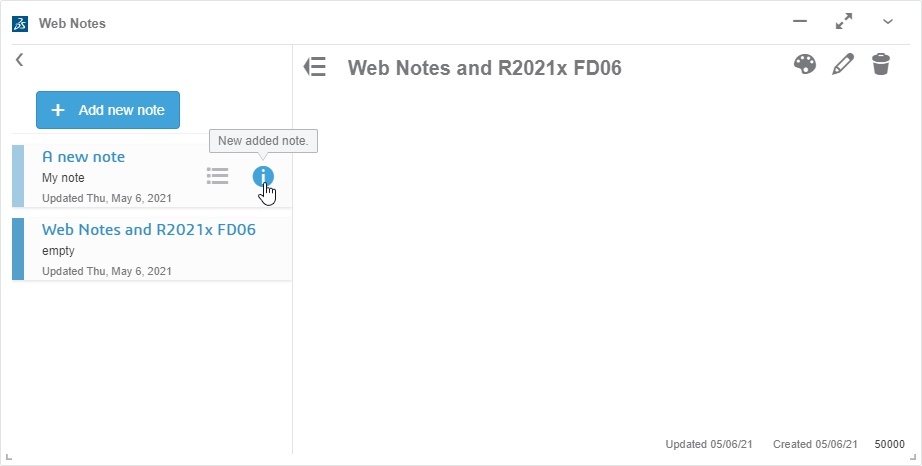

Web Notes improvements
  • User Interface improvements

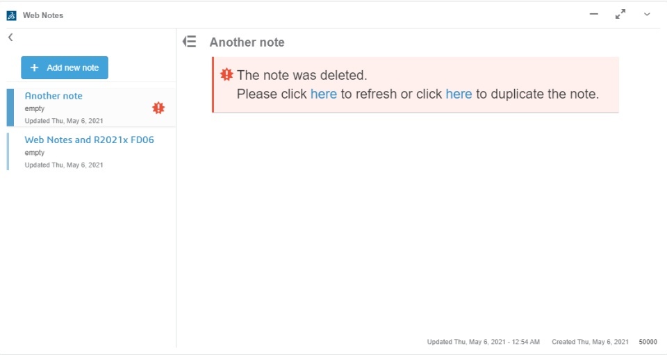

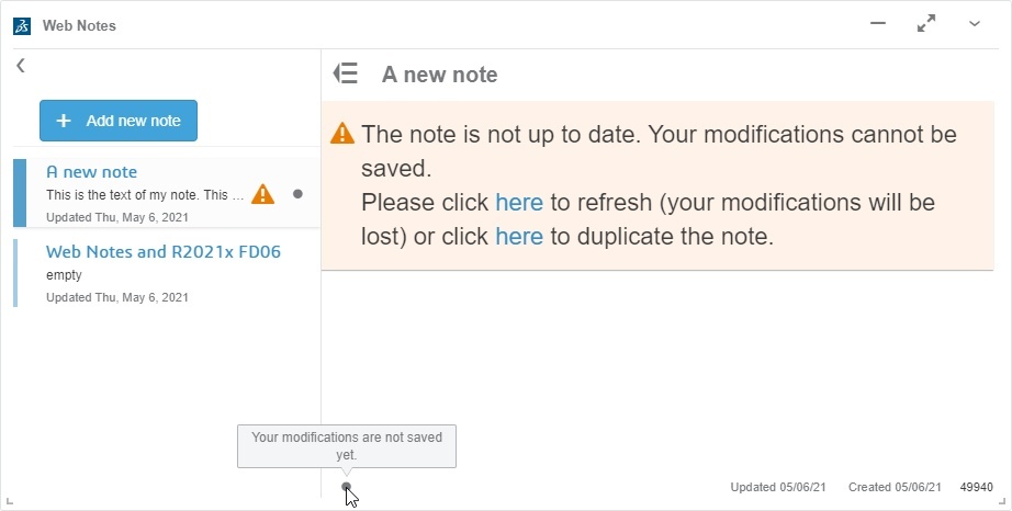

    New icons have been added on the interface to alert you of a new note, a modified note, a deleted note, a failed to save note, an edit conflict, a delete conflict. Here are some examples.
  • User Experience improvements
    • There are improvements with the rich text editor toolbar
    • Visual indication available at the bottom of the notes when data is being fetched or saved

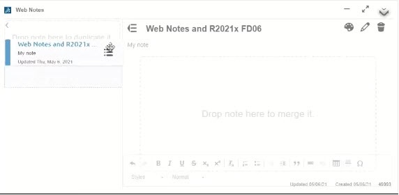

    • Previously you could easily duplicate notes by dragging and dropping it to the dedicated area when at least two were in the widget. You can now do the same with just one note the widget.

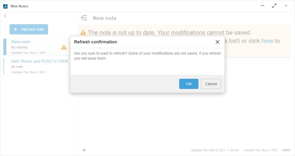

  • If you are trying to refresh using the Web Notes widget dropdown menu while at least one note is modified, then a refresh confirmation panel is prompted to you.
  • When searching for keywords in the notes of a dashboard tab using the Search in Current Tab, the non matching notes are hidden. This is to prevent recording the notes while they are filtered as well as prevent adding new notes.
  • ​​​​Performance improvements
    Web Notes uses a new way to save note's data, which is more reliable and will improve concurrent edition by reducing the possibility to erase data of other users. Also as only the modified data is updated instead of the entire widget data, there is less chance to have timeouts on slow network.

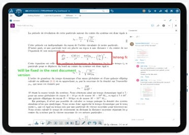

Share annotations as comment
It is now possible to facilitate the social collaboration between community members by commenting and annotating a PDF media in 3DSwym.
This cross feature 3DPlay-3DSwym makes it possible to share annotations to others users on a PDF media stored in a 3DSwym community or conversation, retrieve all comments associated to the PDF media and open the annotated version of this same PDF media

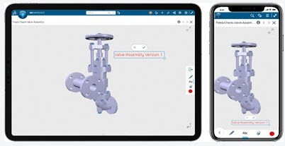

Text annotations enhancements
The text annotation user experience has been improved and redesigned, especially on mobile device: User Experience is now unified across all devices, with ability to edit Text Annotations.

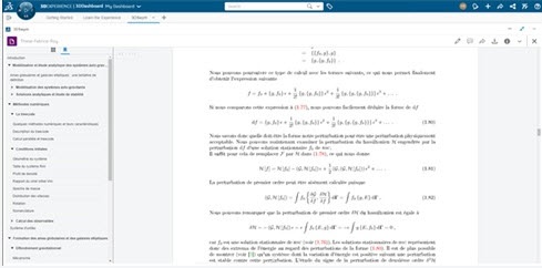

PDF scope improvment
3DPlay now supports Bookmarks and Attachements in PDFs

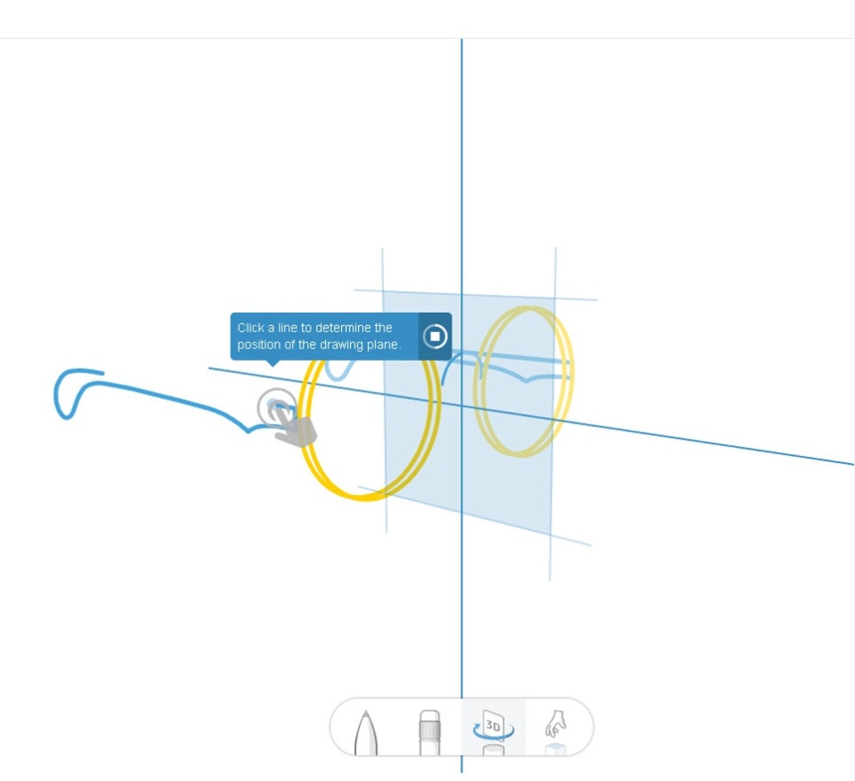

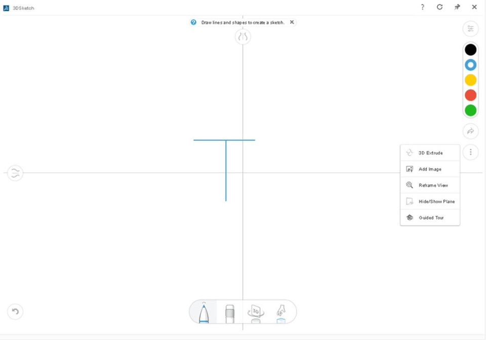

3DSketch

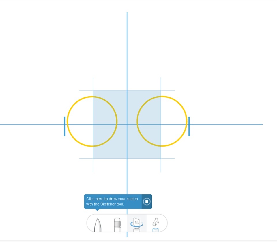

Let's find out what 3DSketch has now to offer with R2021x FD06:

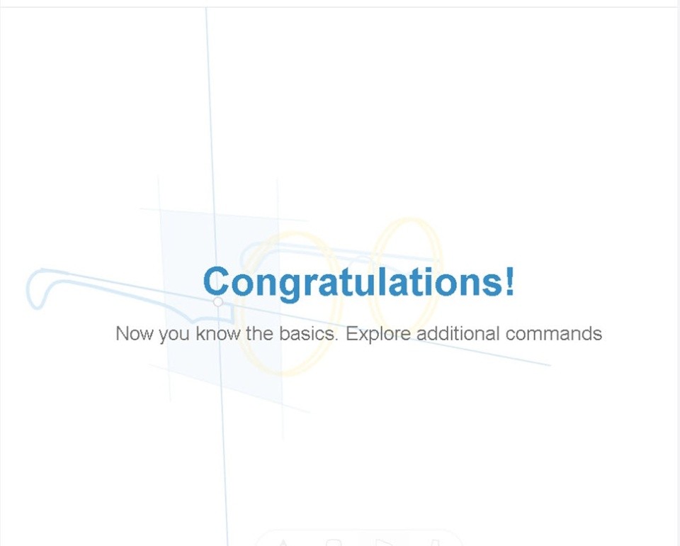

  • Quick Tour Immersive Experience
    This let's you discover 3DSketch tools with an intuitive and immersive experience.

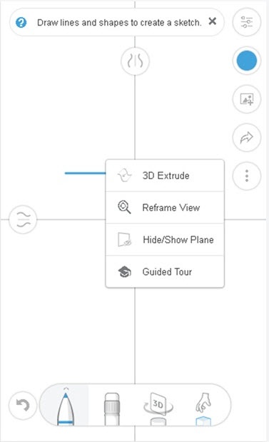

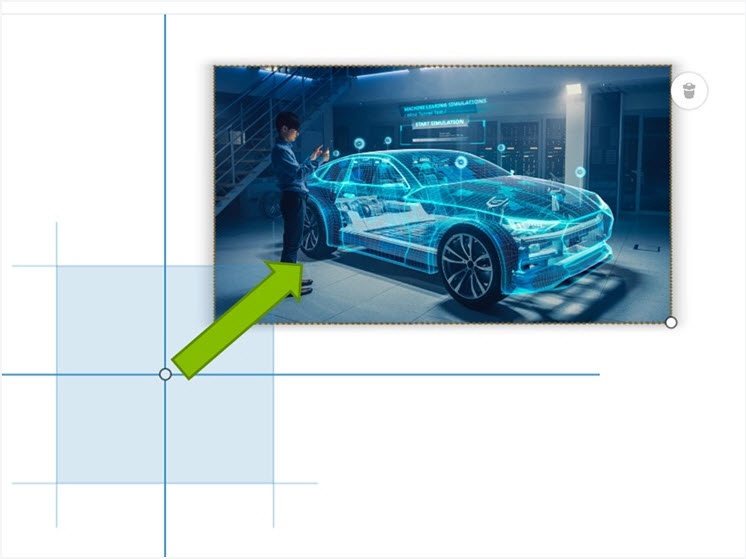

  • Media Manipulation (Scale, Move, Rotate)
    • Single manipulator to Scale, Rotate images
  • Drag picture to move it
  • Frame responsive improvement for Mobile (auto collapse command access in more button)
    • Mobile
  • Tablet / Desktop

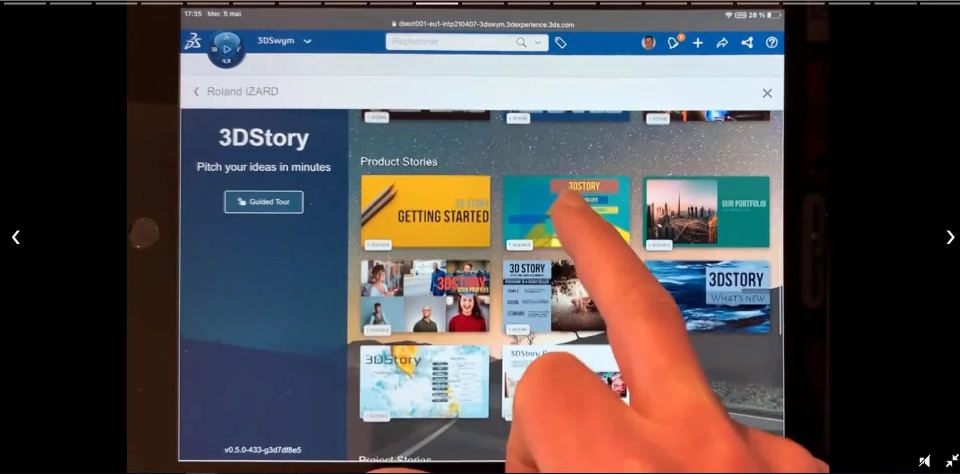

3DStory
here are all the new features of 3DStory in R2021x FD06 all presented to you in a 3DStory!
