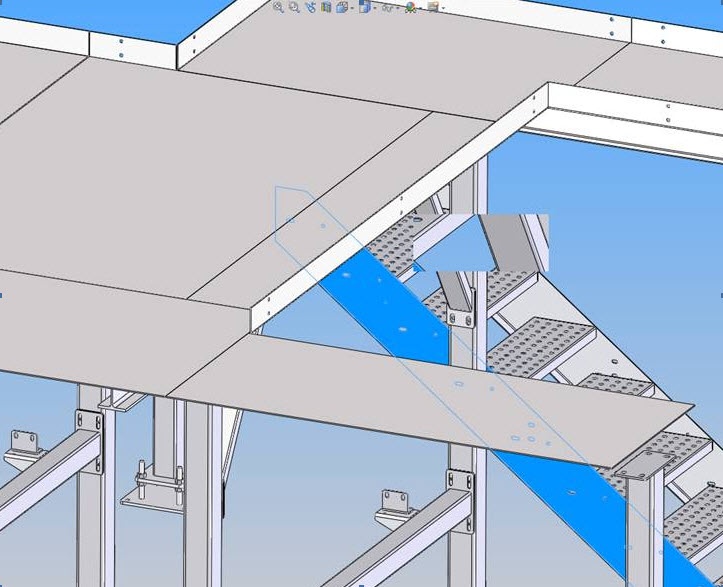

Our company has bought new computers for engineering.
The computers are Dell Precision T3500 with 12GB RAM and Nvidia Quadro FX3800. OS is Windows 7 Enterprise 64bit
Solidworks version installed is 2010 64bit SP4.0.
Since we started using the computers there has been a problem with the zoom function. On all of the computers…
Often, the screen freezes for a few seconds during zooming. The problem occurs when you click on a surface so the "quick menu" appears, and you then zoom. During the subsequent zooming, the entire screen freezes except for the small field that held the quick menu. (please look at attached picture)
The problem is the same whether you are working on a single component or a large assembly (more than 1000 components).
If the SolidWorks window is moved to the secondary monitor, the picture freezes every time you zoom and the quick menu is displayed on the monitor.
We have been in contact with our Solidworks dealer. They have suggested installing different  (older) driver versions. Also we have downloaded and installed newest driver versions from Nvidia website.
We have called Dell. They suggested to upgrade BIOS, and change some performance settings in the BIOS.
None of the above has helped us…
We would appreciate your input.

DG 2010-10-06 Best Answer
Jakob welcome to SW forums
Though it seems like a graphic problem only but can you reinstall SW on any one of the machine to test. Make sure you re move the SW completely before installing it again (Read these post on uninstall/install SW: https://forum.solidworks.com/thread/29679, Clean install )

Before re-installing, test using only one monitor. If it is not a direct video card/driver problem, the chances are it is a dual-monitor display problem.

We have also seen it on various occasions.  I have had success in getting it out of that mode by resizing the tree pane - this forces the graphics area to adjust.  However, this only addresses the symptom, not the cause.  If this is something fairly repeatable, you can try running for a while with software OGL turned on to see if the problem goes away.  It probably will, but you will also see that the graphics performance is slower and not really usable that way.
My conclusion so far is that it's a driver issue that hasn't been worked out yet.

Do you have the Windows Aero feature enabled in the Windows UI?
What you are seeing is a symptom of the Windows Aero Desktop being disabled.
SolidWorks uses Windows Aero code in refreshing the SolidWorks graphics area.

Hi Anna,
enabling Windows Aero solved our issue
