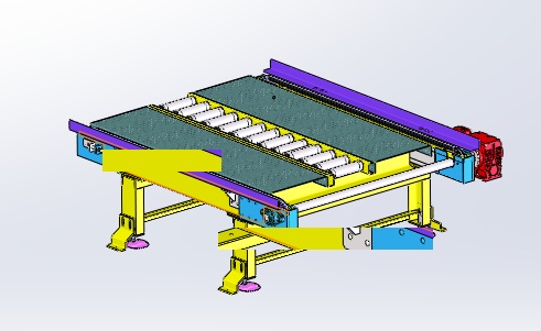

One month before i have upgrade SolidWorks 2011 to 2012 sp1 ,ever since i am facing the zoom and rotate problem ,it won't happen always but very frequent ,when i try to zoom or rotate the certain small area only working the whole window not working ,to recover regional window every time needs rebuild
