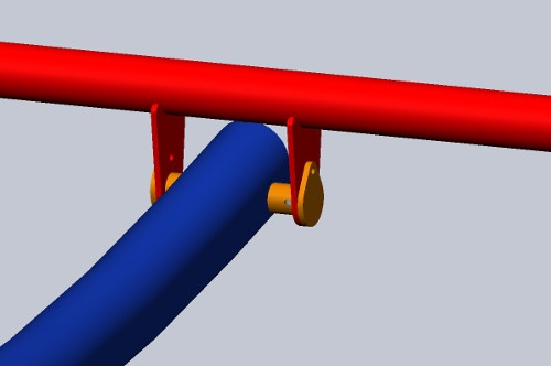

Here's an example.  The first image is the parent assembly.

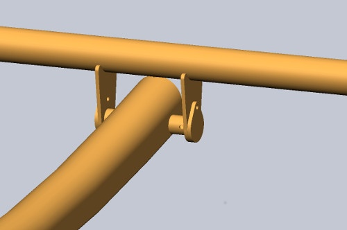

The red parts are a subassembly (all subassembly parts have had their colors individually set in the parent assembly).  I opened the Red subassembly (right clicked on it and open it).  I added a new configuration but didn't do anything else.  Saved and closed the sub-assembly and this is what I see when Solid Works goes back to the parent assembly:
I know all the parts are switching to the parent Default Shading Color because at this point I can go into the parent assembly properties and change this property and everything changes to the new color.
Again, if I save, close and reopen everything goes back to the original image colors.
