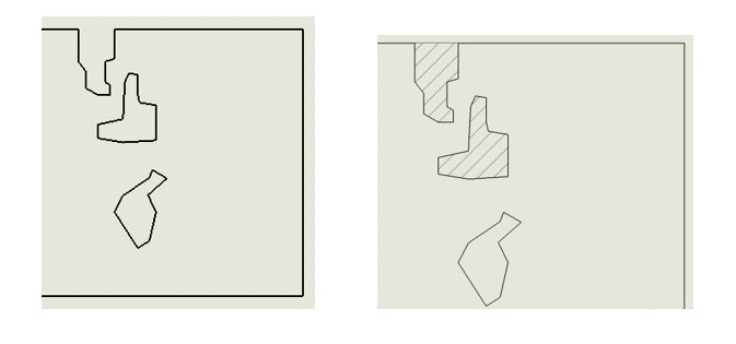

I needed a way to show X Hatch, on a drawing, in 'openings' (Through All) on a part.
I searched this site but I couldn't find anything.
So I same up with this technique using sketches and X Hatch.
1/ click on the view to activate it.
2/ select ‘Sketch’, Convert Entities, with Select Chain & Inner loops one by one selected.
3/ select one line and the loop is highlighted, then ‘accept’
4/ select ‘Annotations’, ‘Area Hatch/Fill’ , ‘Boundary’ , select with window then delete 'Face' from the list.
5/ Accept. (X Hatch is added)
The top shape on the edge works as well. A sketched horizontal line was added to complete the loop
It goes pretty fast once you do it a few times, like most things.
If there is a better way, I would love to hear about it.

When I need to be clear where a opening/cutout appears, I usually place a leaderless note ("OPENING" or "CUTOUT") in that region (or, if the note text won't fit well, a dot leadered note with the dot in the opening and the note text outboard of the part).

Not sure if this will work for your case.  It creates the hatch in all closed inner loops.  It would need a little more work to get the outer one with the sketch line.  See video below.  The zip file contains the macro and a macro button.
