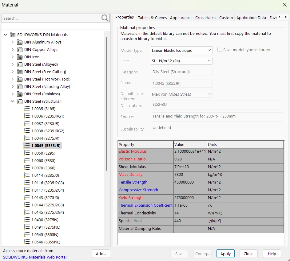

Seems wrong to me that steel S355JR has yieldstrength of 275MPA?

The minimum yield strength of that material is dependent on the thickness:

I do not feel it's wrong, it could be because it's not a standard you're used to
The following KB articles may be useful:
QA00000122214: How do I interpret the Yield Strength and Tensile Strength values for DIN Steel (Structural) materials in the SolidWorks DIN Materials library?
QA00000124730: How do I interpret the ‘Yield Strength’ and ‘Tensile Strength’ values for ‘DIN Steel (Stainless)’ materials in the ‘SOLIDWORKS DIN Materials’ library?
