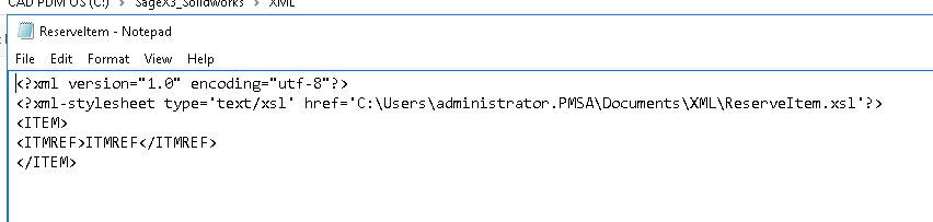

1) Create XML

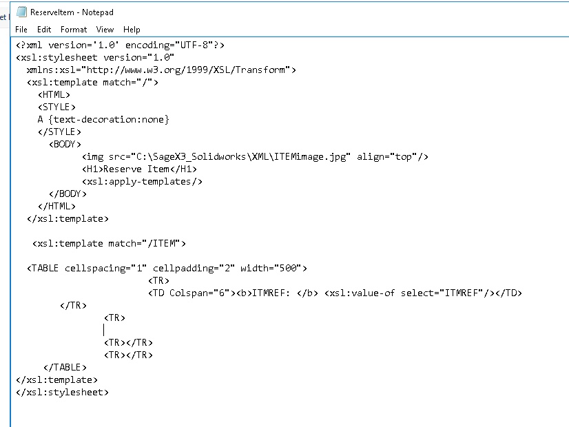

2) Create XSL

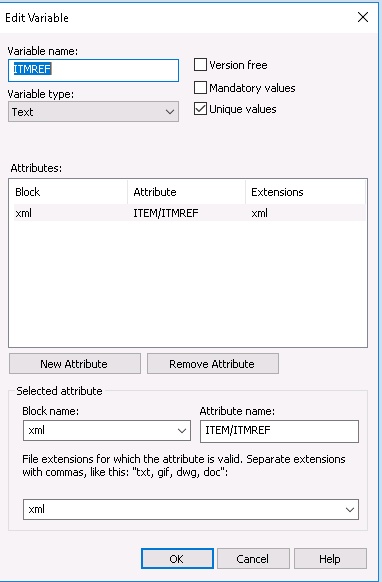

3) Linked the variables to  XML

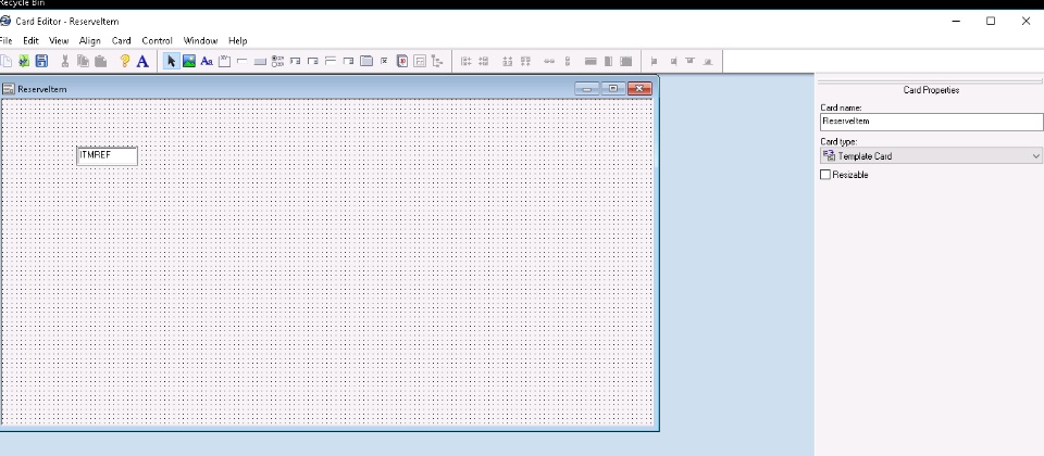

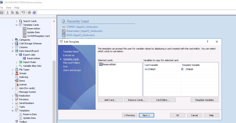

4) Create a template card
5) Create a template

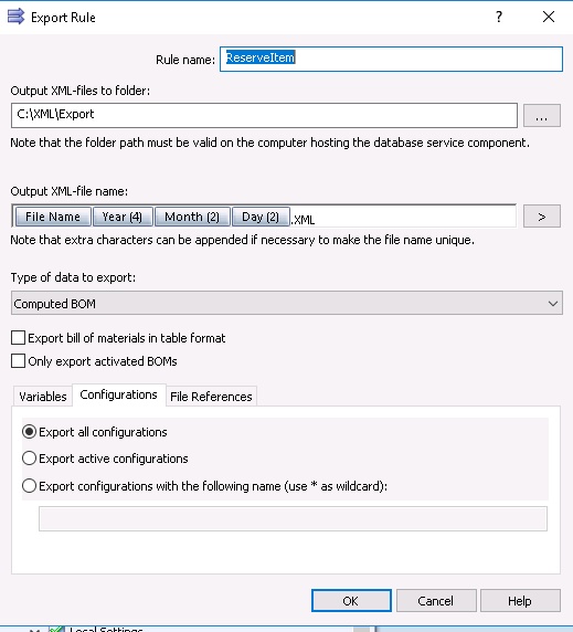

6) Create an export rule

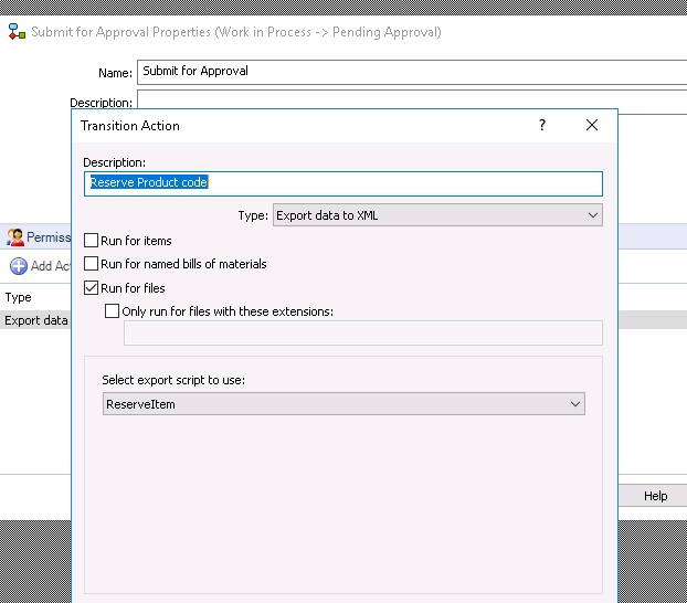

7) I have specified which rule it should use in the workflow

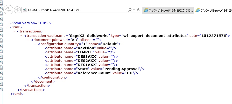

8)My issue is that when I  create an XML export via changing the status of the file, the resultant XML file in no way resembles my XML file.

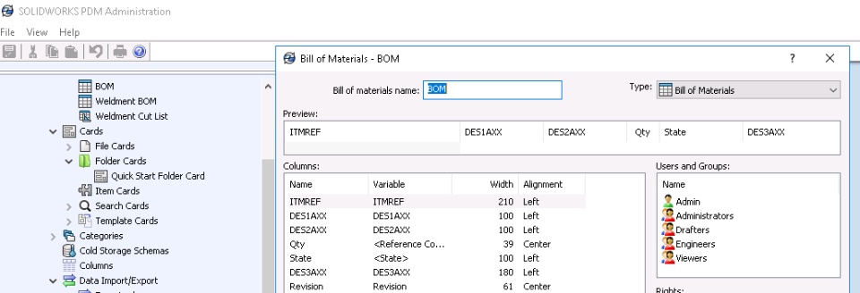

I should be getting a blank file or least one that has only one item number. It seems to be pulling this format from somewhere and from what I can see its puling from BOM
Can anyone assist me with where I can define the XML used to for a particular rule?
