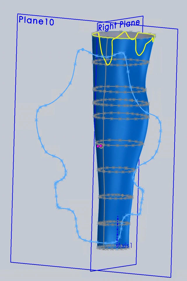

I am having trouble with the wrap feature. I have created a lofted body, and a 2d sketch that I want to wrap around the object. The wrap is not working, with it just appearing as some squiggles at the top of the body. Does anyone know why this doesn't work, or another way to approach a solution?

Your wrap method may need to be set to spline surface in case its on analytical. Sometimes the sketch can't overlap as it wraps around so try reducing the width of it as a test before proceeding forward

The wrap feature is set to spline surface - it wont select the loft otherwise. I made a cylinder and tried to wrap that with the sketch. If it's set to spline surface it does the squiggly line thing. Set to analytical it works as expected, but that doesn't work with the lofted object.

Huh. I was going to try out the flatten surface tools, so I cut a seam along the back of the lofted part, and now the wrap works as it should.
