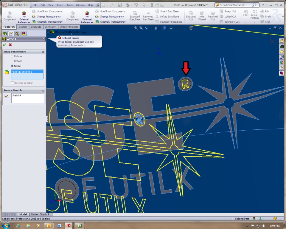

I am trying to wrap a text symbol -the letter R- onto a cylindrical surface, and even though the preview shows the desired result, I get an error message telling me "Wrap failed, could not use any contour(s) from sketch".  My contour is closed, and I can't figure out why this won't work.  Any ideas?

Well, attachments on the forum aren't working well right now. Right click on the text and chose "dissolve sketch text" and see if that works.

I had to look to make sure it wasn't that easy.  The text has been dissolved already, so that's not it.

I just finished redrawing the letter "R" free-hand, and I get the same error.

I think you may need to select the actual face the "R" will land on - not the main cylinder.

But that's the only thing there.  It's just a basic cylindrical surface.
I just now figured it out!
I had to do the "R" first, and then do the rest.  Now I'm going to see if I can project my wraps onto a sphere, since spheres aren't on the list of wrappable shapes.
