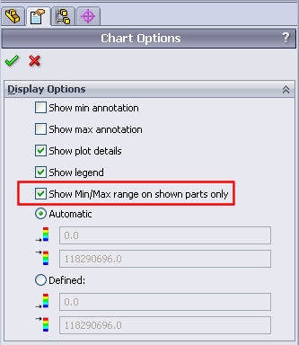

In a mixed mesh model (beam and shell) -  I have placed an shell part in the model (this part has no impact on element 300).  I am confused.  I have worst case stress values that are negative.  Even if I have an insignificant shell part in the model, the Worst Case Stress scale is now in the negative region.
For element # 300:
Axial Stress = -500 psi
Bending Stress 1 = -20,000 psi
Bending Stress 2 = +2500 psi
Worst Case Stress = -500 + -20,000 + (-1) * 2500 = -23,000 psi
Can someone help with what is going on here?
