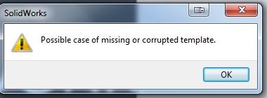

I tried opening a parasolid but I receive the following error

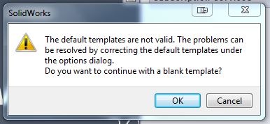

The error repeats itself after I click OK.  The second time I click OK I get this message:
I have to hold Esc for probably ten seconds to cycle through countless identical messages.

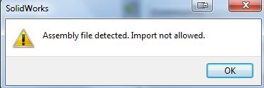

procedure that doesn't work (errors below):
http://help.solidworks.com/2013/English/SolidWorks/sldworks/t_Importing_Geometry.htm?id=e378d6f322ec48c9b9dbcbab6368c2d9#Pg0
