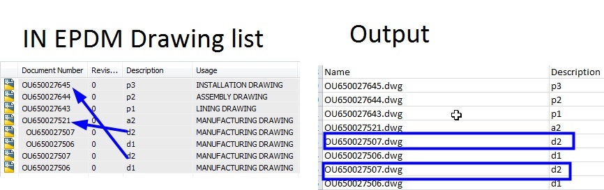

The BOM I create is basically artificial, With Quantities modified based on other inputs.
For my operations I need to understand their level in the tree, when getting the computed BOM it returns all items in a flat tree.
This leaves it impossible to tell the hierarchy and where sub drawings are used. This really becomes an issue when a part is used in as a sub assembly and also in the Main assembly, as I can only detect the part not the location is in the tree.
Is there a way to either detect what the hierarchy is, or the get top Level BOM?
